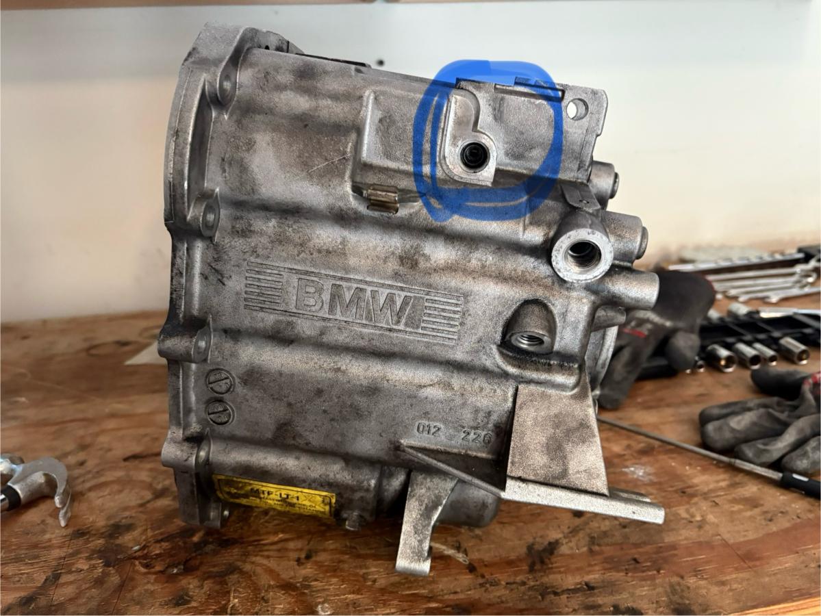

    • Questions Part 1 - On the right of the tail shaft housing there is a cap that covers over 5 holes where the detent springs, balls & sleeves are located. Now don't quote me on what I am about to say here because I am not certain but I believe that the balls sit in between the pin or pins down in the holes on this location? Correct me if I am wrong please. Also how many pins are there under the balls?

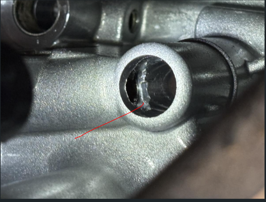

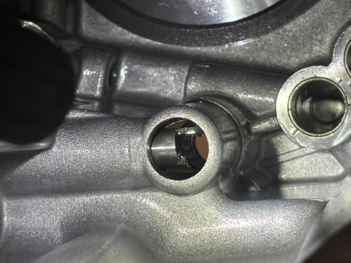

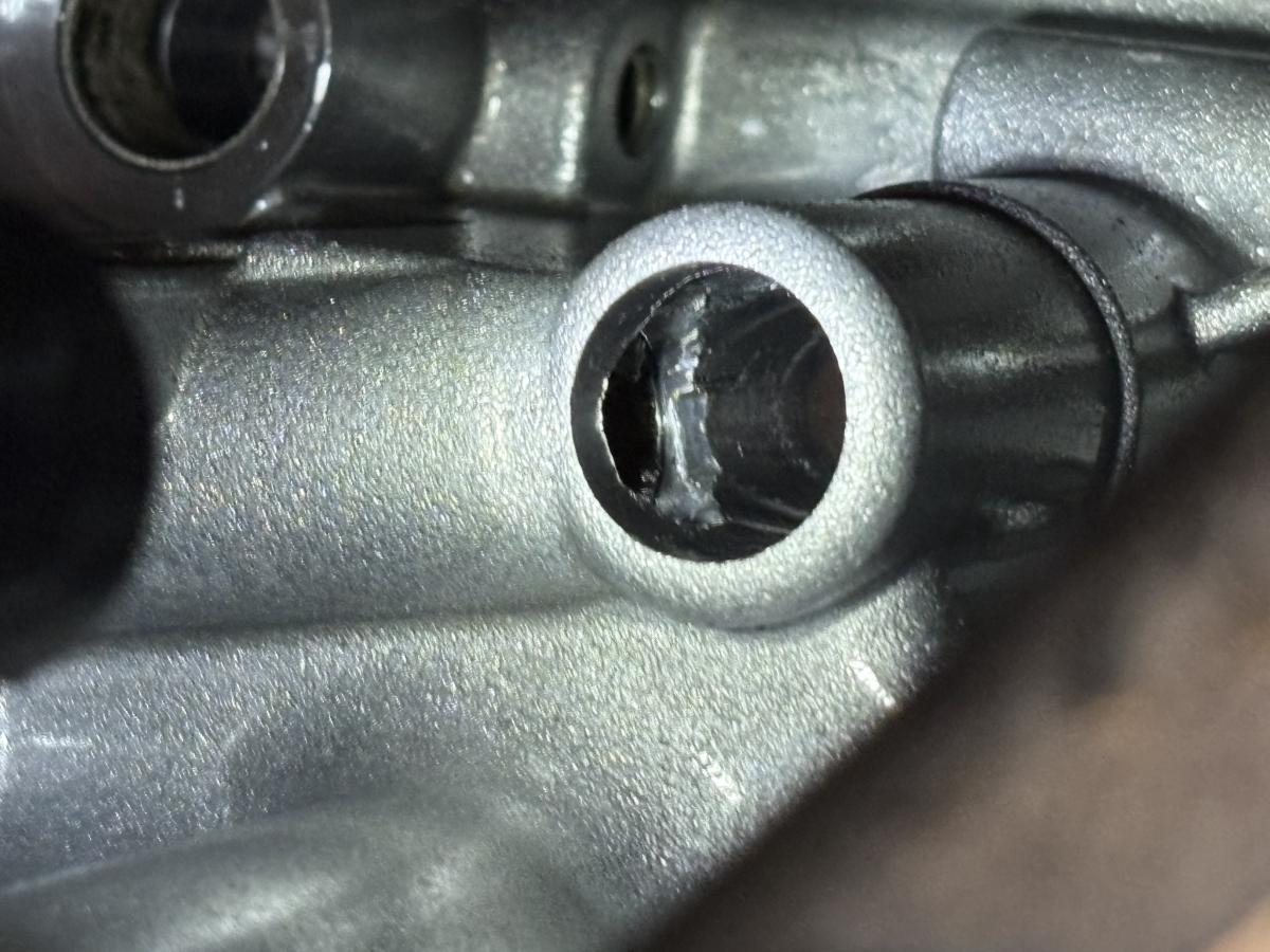

    • Question part 2 - Where the roller head sits internally the bore is damaged I really can't explain the damage or don't know what to call it. The question is can I just file the damage down? I am going to attach some photos below.

    1. The early version used the balls and the new version used sleeves, and so you only have either balls or sleeves but not both, unless someone had partially changed them. The pins and the balls are not in the same hole. I think you are talking about the inter-lock pins (going 90* with the ball/spring) that prevent two gears engaged at the same time. You should not care for these pins unless they were removed to remove the tail cover.
    2. The roller pin is long enough to slide in the hole with minor damages, so just smooth out the hole with a file until the roller pin can slide freely.

      So here is what I forgot to mention on Question 1. So my buddy was playing around with the Tail housing and when I got to it I noticed the balls were missing from the detent holes .. Found the balls on the table next to two inter-lock pins I also did have a pin in the hole that I noticed before & is now not in there assuming that one of the pins came out of the hole since the pin is missing. What really confused me is I seen two of the little interlock pins and only seen one pin in the detent hole. So I take it both of these interlock pins go in there? If so where and how do they sit?

        "I seen two of the little interlock pins and only seen one pin in the detent hole. So I take it both of these interlock pins go in there? If so where and how do they sit?"
        These pins are only in the horizontal hole, not the vertical holes that house the balls and springs.
        The two short pins 12mmx4mm going inside shift rod R and shift rod 1st/2nd; the long 65mm pin going into the left side of the cover between the 5/6 rod and R shift rod.
        About the sleeves and balls: 3 sleeves and springs are in the odd number holes for 3 shift rods detent. Two 8mm pins and two 8mm balls are inside the even number holes of the total 5 holes.
          Perfect, so the two 8mm pins is indeed correct. so the balls sit directly on top of these 8mm pins inside the even number holes?
            8mm ball is under the pin.
              How does the inter-lock with pins/balls work?
              Ex: When ½ rod moved to engage the gears, its diameter pushes the balls next to its shaft outward. One ball gets into the ¾ rod groove and locks the rod, the other ball gets into the R rod and pushes the 12mm pin out which pushes the 65mm pin into the 5/6 rod groove. So with ½ rod moved to engage 1st or 2nd, the balls and pins moved to lock up 3/4, R, and 5/6 rods.
                This hole is for the long main shift rod to slide fore/aft, so if you smooth the bore for the rod to slide freely then no negative effect. I think you guys damaged it while trying to remove the damaged roller pin.
                Make sure the roller pin also can slide freely in its hole.

                  what do you think I should use to properly smooth it? Also yes I’ll make sure it moves in & out freely as well. Not to be a pain but I really want to make sure I get this right here as well .. the holes where the 8mm ball & pin go into the pin is visible in the hole placed in horizontally & the ball sits right on top of the pin correct? After that is all set up you install the flat top sleeve into the holes where the ball & pin rest?
