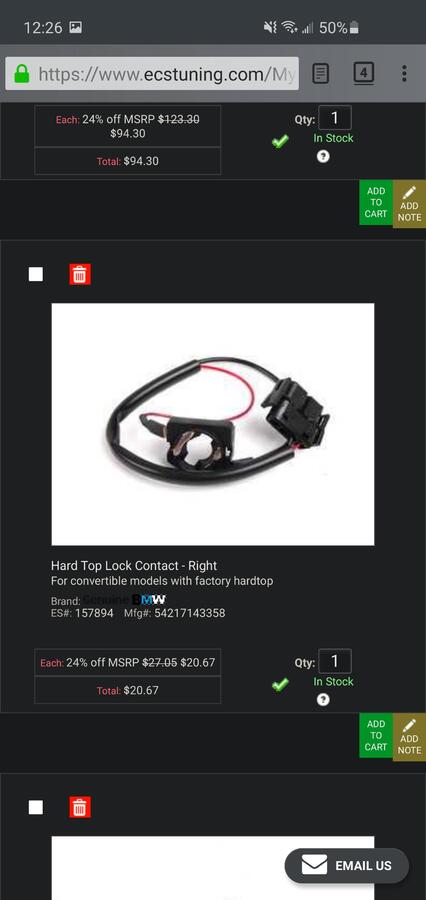

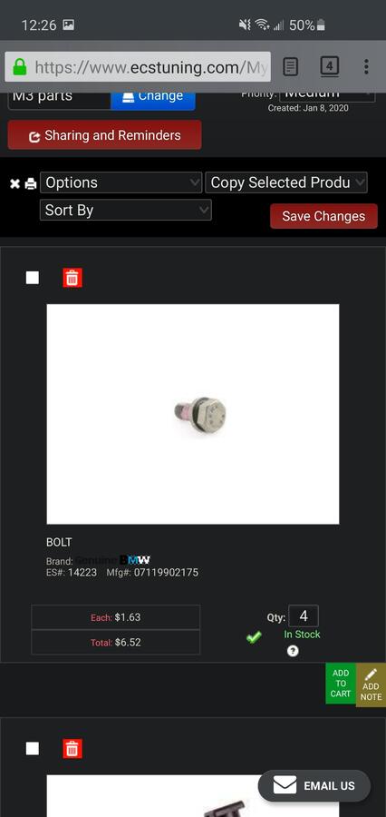

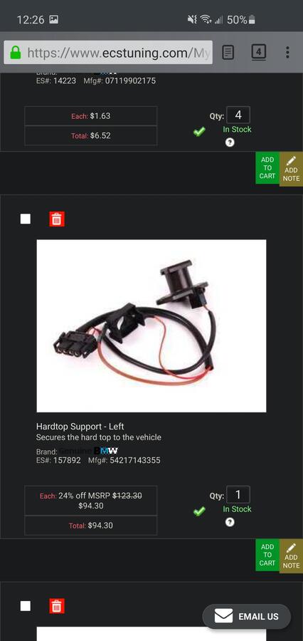

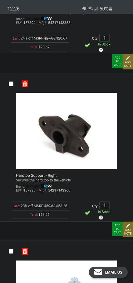

          The kit was made up of the below part numbers. I went down the road to piece it together before I bought a set off Facebook.
          Bolts x4 07119902175
          Left support (includes wiring and mount) 54217143355
          Right support (wiring separate on this side) 54217143360
          Right wiring 54217143358
