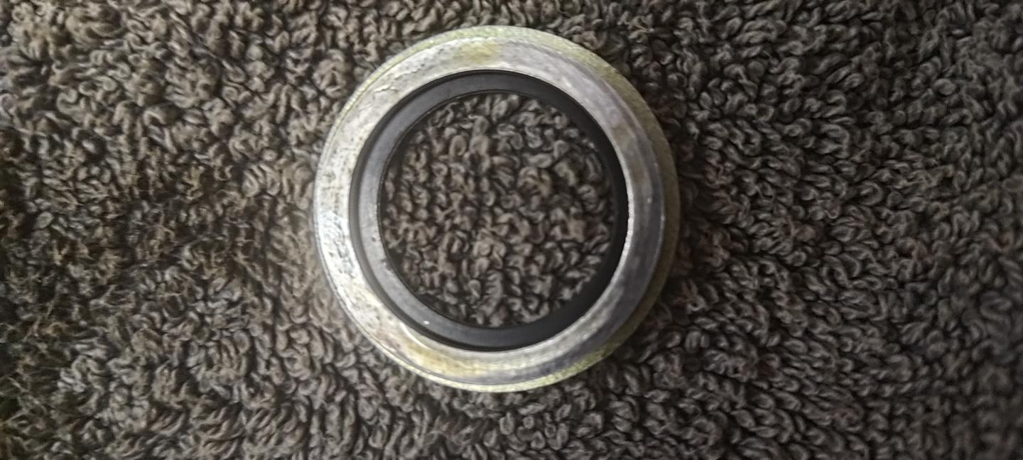

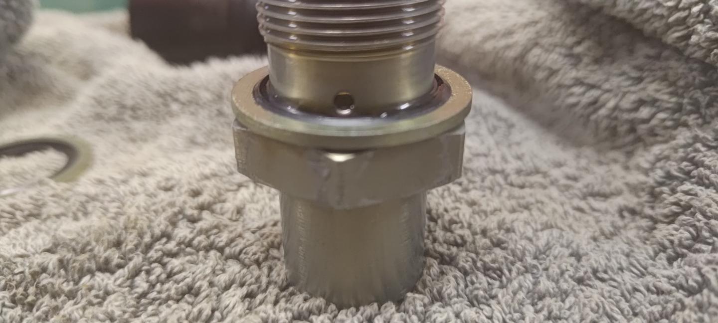

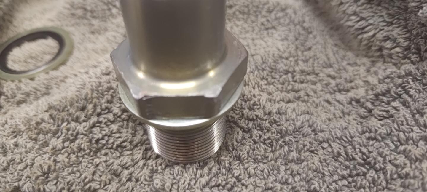

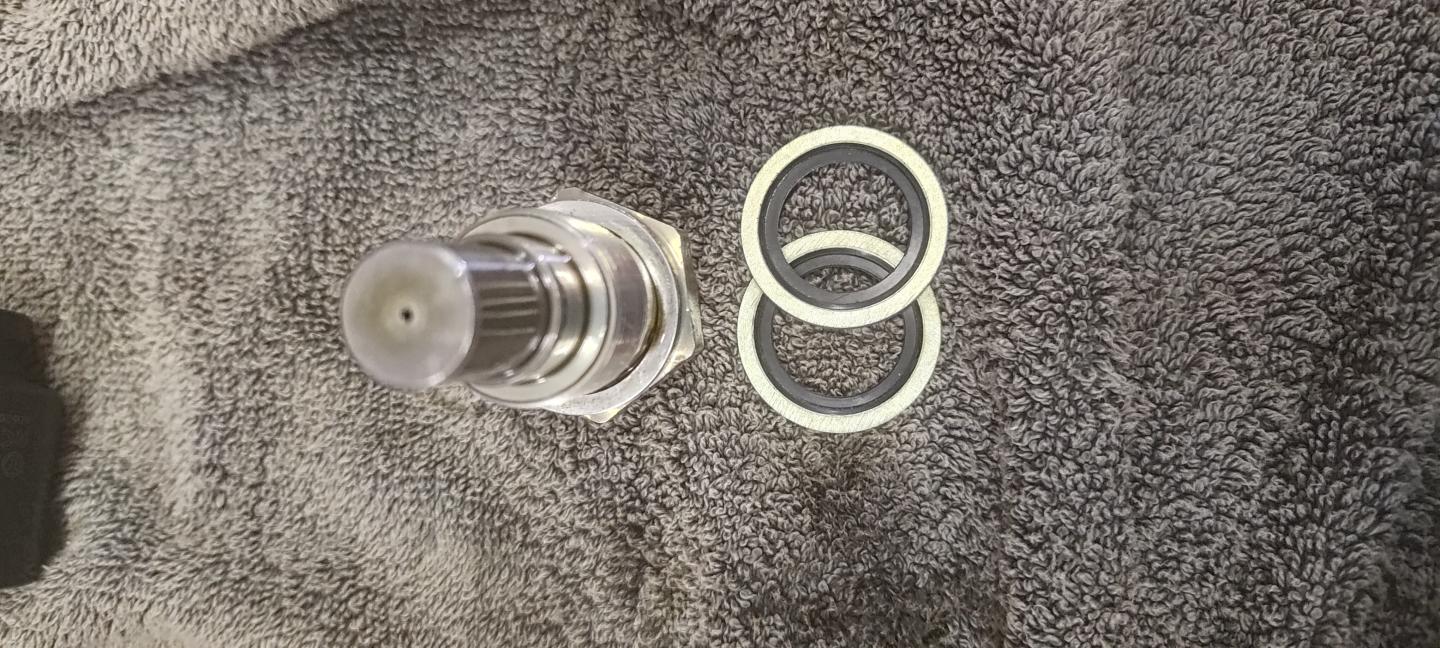

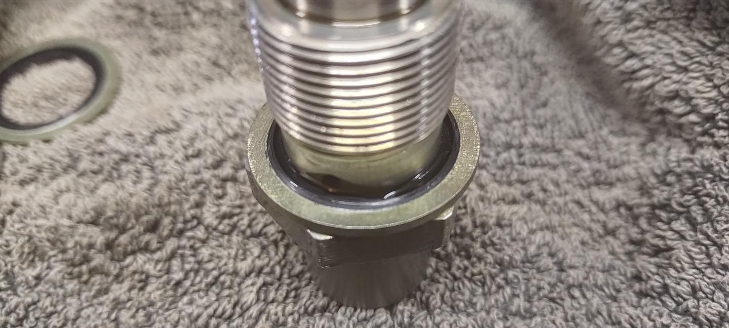

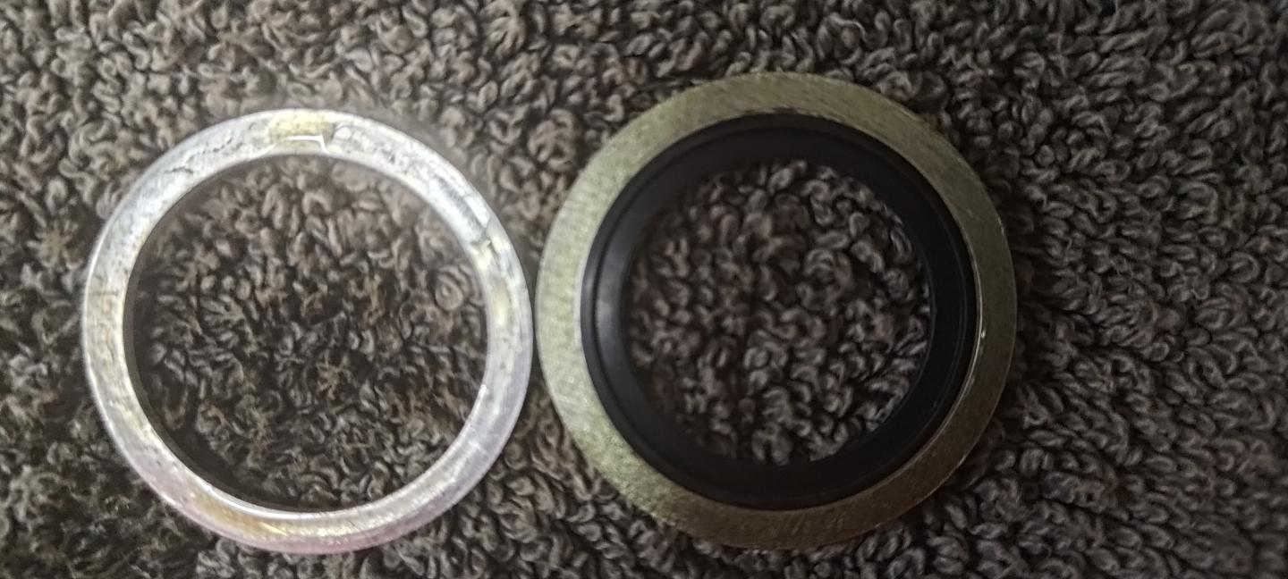

    Finally was able to source some of these in Australia
    Hopefully this will cure my timing chain tensioner leak and many others
    I replaced mine with a new one and new tensioner and so far so good. I torqued to 70 Nm, we shall see. I had to use flex head 3/8" torque wrench with 1/2" drive adapter and U joint. I also found a copper alternative that I believe is the same ID/OD and will use that if this leaks again. VW Audi part N0438541.
