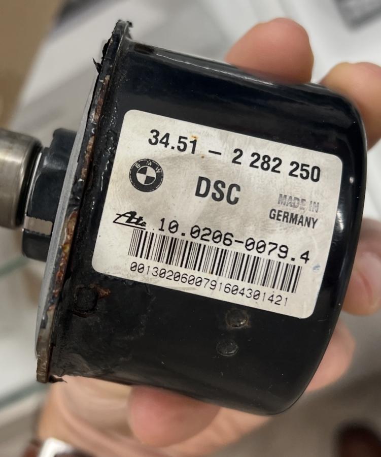

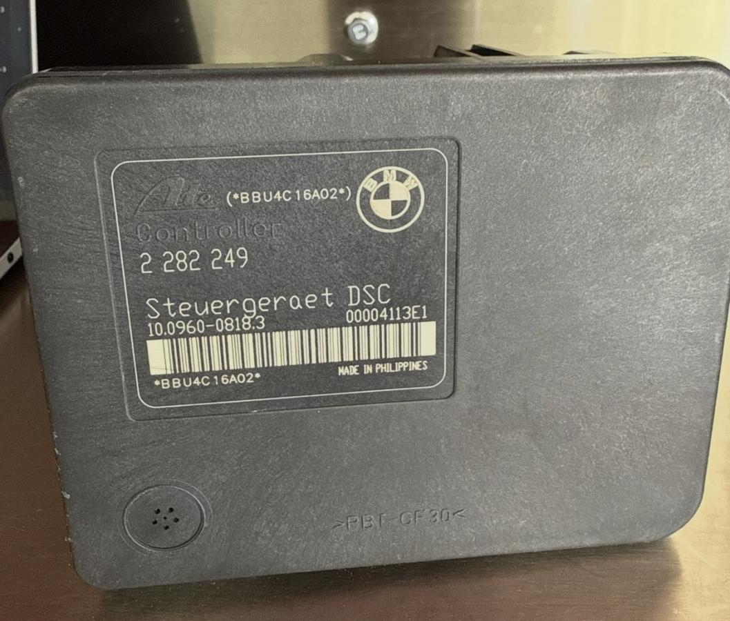

      Do you know if this is the correct pin layout for our MK60? My car is a 2004 so I'm guessing this is the right one - see my actual ABS / DSC units and model numbers below from when I had them pulled a few months back
      Correct pin layout? https://bmwteka.com/wds/en/e46/0c9dc1ac
      Click image for larger version  Name:	IMG_8387.jpg Views:	0 Size:	135.8 KB ID:	314855
      Click image for larger version  Name:	IMG_8389.jpg Views:	0 Size:	70.8 KB ID:	314856
