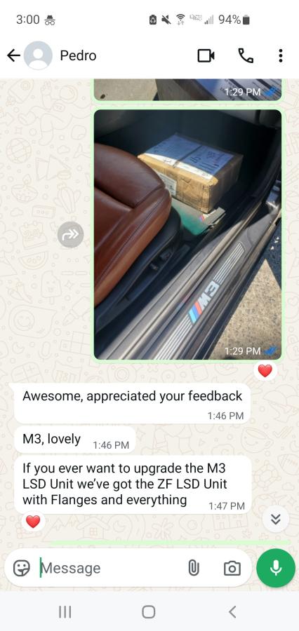

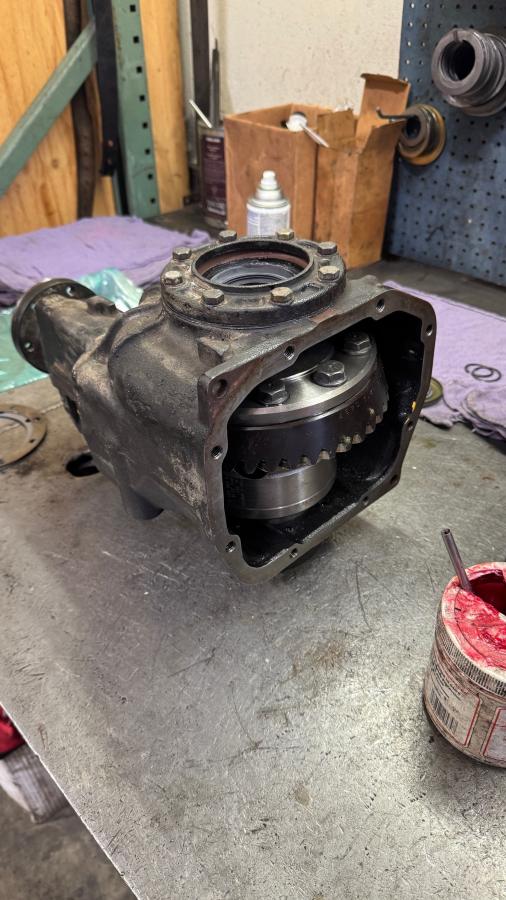

    Just went through this. I used Peaky parts (Pedro) and had Unitrax here in Corona do the rebuild. 950ish and I supplied the bearings, ring, pinion.

      I'm in Houston, I have a guy that can build the diff if you supply the core and parts. $400-$500.

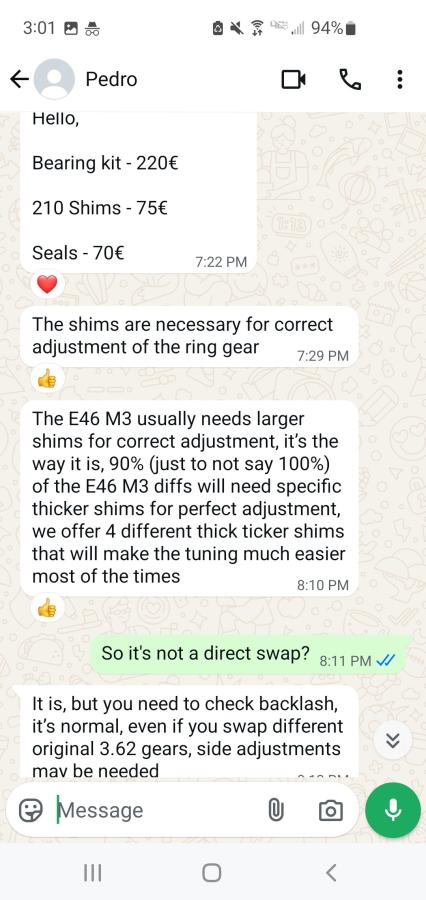

        This is a dangerous assumption, ask me how I know.
        I needed a thicker shim on the RH bearing cap, and a thinner on the LH one, I also needed a thinner shim for the pinion, and by some.
        It helps to have shims of different sizes but you won’t know until you are there and mesh it. I guesstimated shims I would need based on loose assumptions and ended up with shims I did not need and still had to get very specific sizes.
        if you do it yourself be ready to take your time, if you let someone else do it, make sure they really commit to do it right and not just do a half ass job, because once there I can see why people would call it done because that was what they could do and you end up with whining noises.

          This is great to hear! I'm currently messaging him! I've seen peakyparts recommended 3 times now!

              Any shim kits you recommend? I'll be having a shop do the job since I don't have the special tools for rebuilding
                For shims I used an eBay store that carries a lot of diff parts, I got tons of pinion shims, yet, they did not have the size I needed (because I made assumptions as suggested here), luckily, the size I needed was included in a set I was still able to get from BMW themselves. The eBay shop has a lot of output flanges shims, but again, without being in your diff, you are shooting in the dark, and even then, you will very likely need to machine / lap shims for proper setup.
                side cap shims sourcesPinion shims
                • BMW (see if they have any sets available) - the 3.2 - 3.475 kit is still available (33129065173), there are several other sets , just change the last number to 4/5/6, etc. some are not available anymore.
                So, as you see, whom ever does it, needs to get in there, change the gears and mesh it, based on what they have, they need to start trialing different shims UNLESS they have the factory tool and know from the start what shim they need, but even then, they MUST do some back and forth to mesh it properly.
                To put in in perspective, to perfectly align the pattern I went to complete different shims sizes than the original, so the assumption that the original shims are close enough is not correct, will it work, yes, but it will leave you with whining noise, unless you win a lottery ticket and it all lines perfectly (SUPER UNLIKELY)
