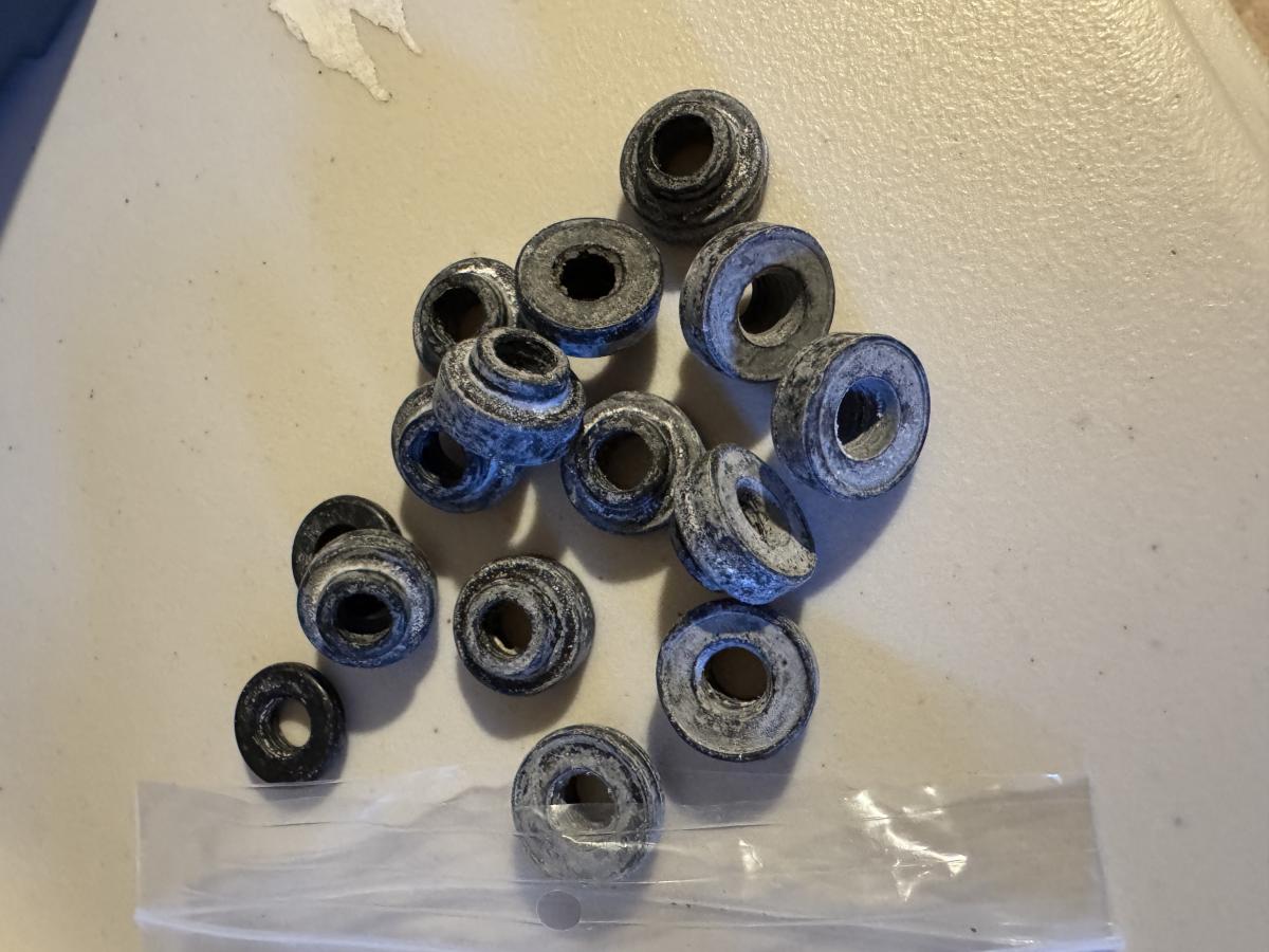

              I would reuse those if they are not cracked. Recently had two grommets that were leaking after reinstalling the valve cover and it turned out the grommets had some build up of that powdery gunk that you sometimes get on new rubber parts (never cleaned them). Gave the grommets and the VC hardware a good clean, reinstalled and it is no longer leaking. All gaskets sealing the valve cover are from 2011 and none are genuine BMW. IMO, clean and keep reusing until they fall apart lol
              Mating surfaces and gaskets need to be completely free of oil and debris to seal properly. Also, spark plug tube gaskets will have an imprint of cylinder head side and that mark indicates how to put them back when you reuse them.

                Okay I've always wondered about that powdery gunk! I had always figured that it's supposed to be left and they're supposed to be installed as is, that it's some sort of seal conditioner idk. But if they're meant to be thoroughly cleaned before installation... that would explain why my VCG grommets have consistently been leaking smh.
                  It's talcum powder to protect the rubber gaskets during storage.

                      I'd just wipe it down but not thoroughly clean it.

                        Found a few grommets in spares "pile"...full of white "powder" for visual reference. Not sure of the brand, I forget.

                            Nope, that torque setting is there so you don't go crazy tightening the nut and go so far as to stripping the stud under it that holds the cam cap. That would be very bad. Hand tight until the nut stops turning is good enough to compress the grommet and have it seal.
                            I've reused those grommets at least 6 times by now. When I undo them, they spring back to their normal thickness. I believe all of them, except for the two front corner grommets, are Viton. Gonna keep reusing them until they stop sealing or crumble.
