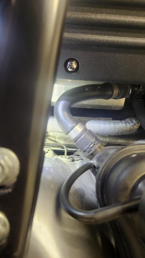

    Can anyone tell me where the tube circling the red connects to, I’m putting my engine back together post a header install. Thanks.
    ‘04 M3
    that drops down on the side of the shock tower, if you look a little bit down the shock tower you'll see a slot where that fits.
      Look where the hose disappears in this photo near the frame rail, you will see a box shapped cutout, route it down through there.

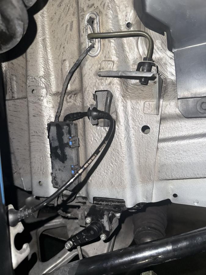

        To state the obvious, it doesnt connect to anything. Its a vent to atmosphere tube.
          Should end up down here:
            Wow ok just a vent, very interesting. Thanks to all!
