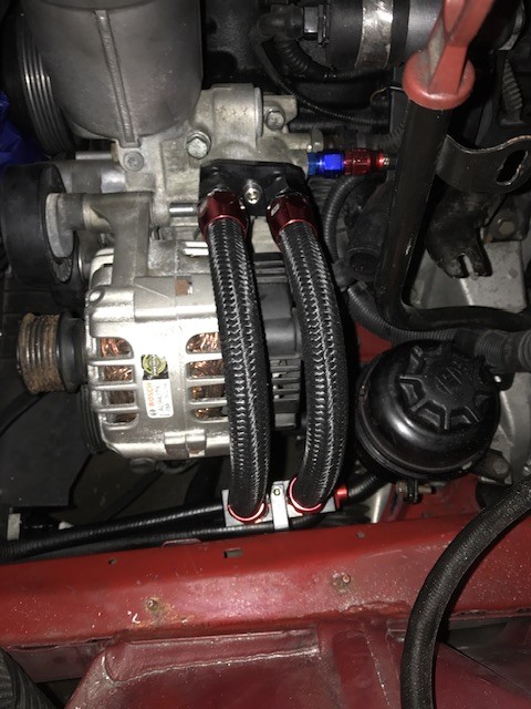

Is there a good solution for the second port on the oil filter housing that has a Bluetooth/BLE sender or can be connected to one easily? Looking for a small solution if possible so that it can be left in place.

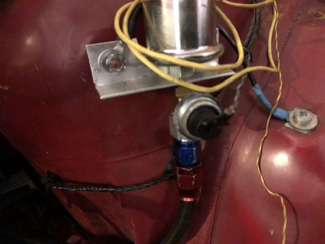

I remote mounted a sender and switch to the strut tower. It protects the switch from engine vibrations.
