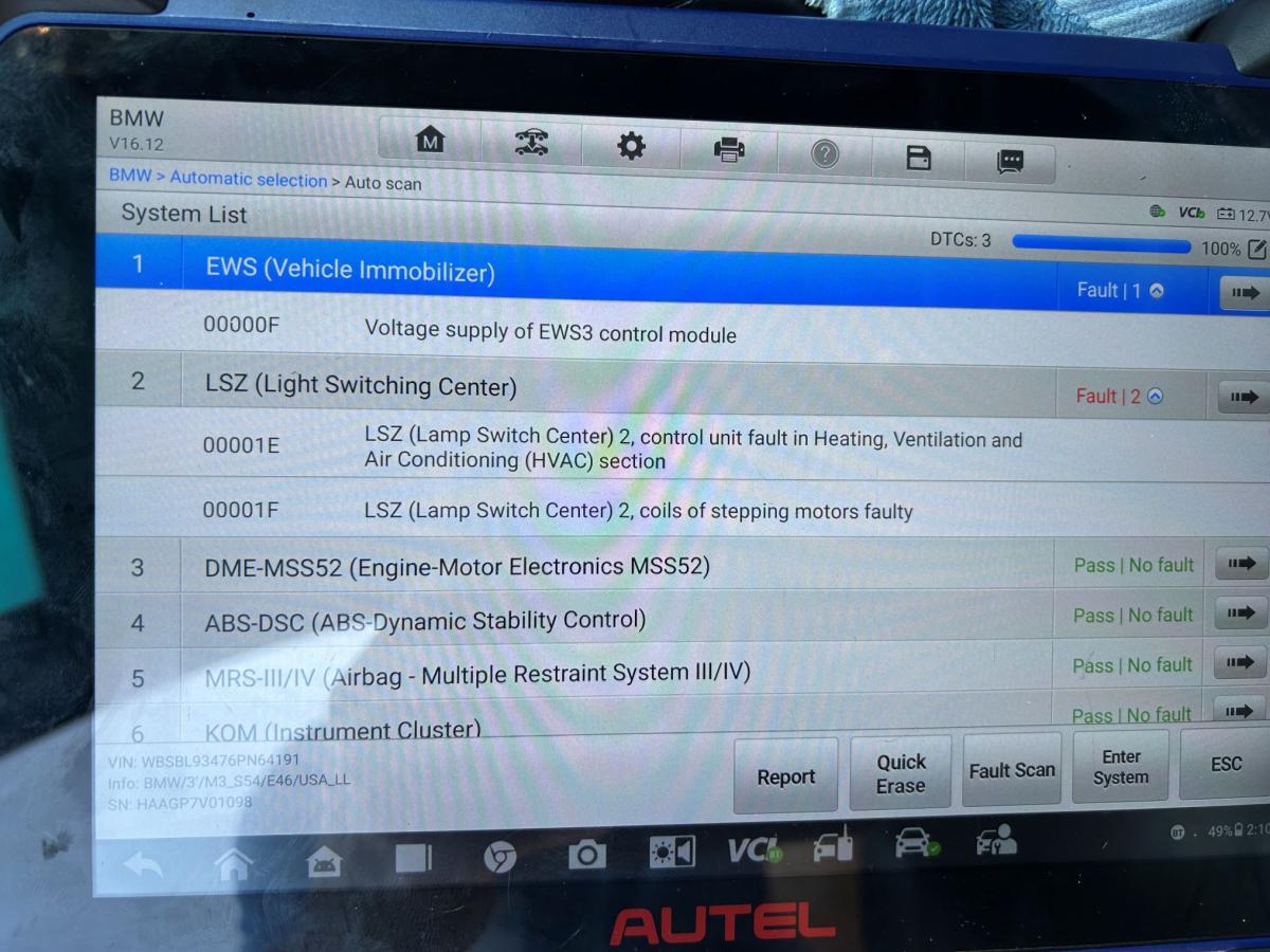

    Done some searching, can't find solution. Car has been showing Service Engine Soon light for a few days. Cleared what I could find on my Foxwell 510. Didn't go out. Went to indy, they found "Voltage supply of EWS3 control module."
    Fuses are good. Battery is only a year old, showing 12.52 cold and 13.89 running. Tried second key. Car is running well. Any ideas welcome!
    Check codes with INPA, EWS shouldnt trigger SES light, according to DTC tables.
      Yes, if SES turned on then you should read error codes that cause the light on.
        Measure voltage at EWS3 plug.
          Which pins?
