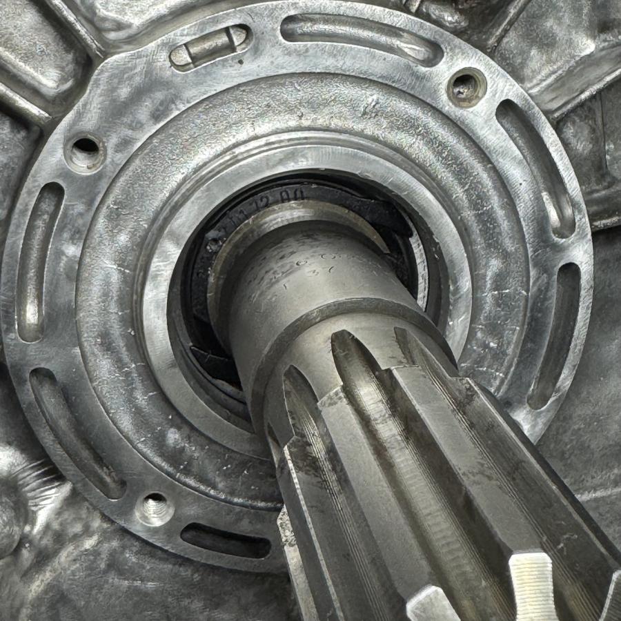

                    1. I didn't know there is a black plastic retention clip in between the seal and the input shaft bearing. Anyone have a pic / drawing of this?
                      I happen to have my transmission out right now for a refresh. Image below is of the plastic retaining clip. It’s made of nylon 66. Some of the tutorials on YouTube for replacing the shaft seal recommend drilling a screw into the seal then using pliers to pull the screw and seal out. I got a bit too excited and drilled into this plastic clip we speak of. Not a part you can readily source. So that’s what I’m dealing with today.
                      And to the OP, you should be able to tell the previous depth by the change in sheen of the metal, it’s shinier where the seal was.
                        Is the plastic clip attached to the rotating shaft, or to the bellhousing? It makes sense if it's attached to the shaft as an oil slinger, as I don't see it serves any function if attached to the bellhousing.
                          The plastic clip (and the metal ring in front of the plastic clip) are mounted on the shaft. They rotate with the shaft, but aren’t necessarily attached because they can also move independently of each other.
                          I’m not sure of the purpose but slinging oil is a good theory.

                            when removing the BH and installing (smg to 6mt), the 2 pieces can interfere with the input shaft if people don’t see them behind the seal.
                              The drill went too far issue won't affect this if the drill didn't touch the bearing, so you are ok as it is.
