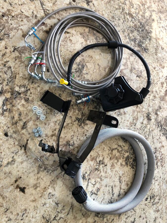

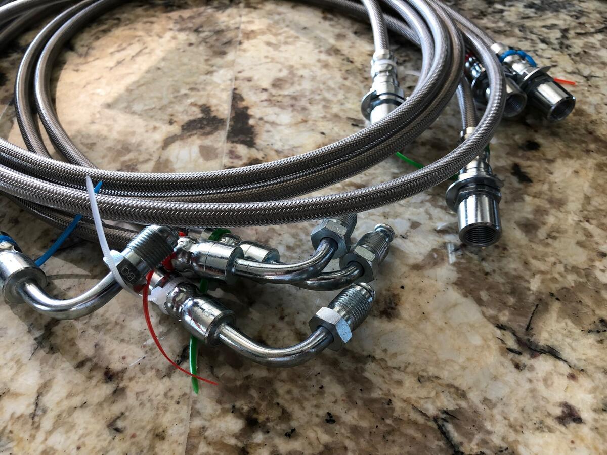

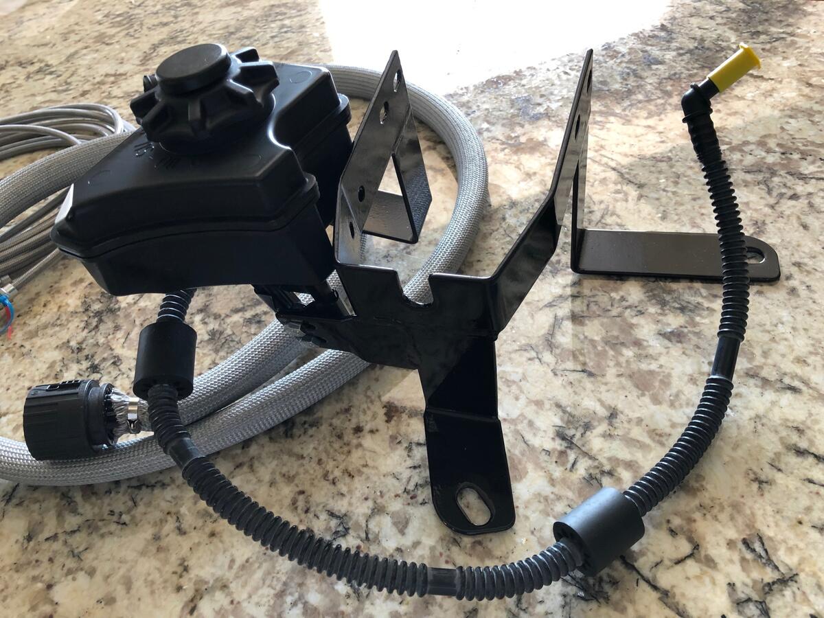

                  Which relocation kit did you use?
                  From M3Forum Group Buy. Has worked wonders, this current problem is definitely not heat related.
                    Ya know... if you just end up swapping and my SMG isn't dead yet (meaning I'm swapping too) let me know and I'd totally buy that relocation kit off you. /shameless
                      Damn you beat me to it. Also interested. Also have no shame.
