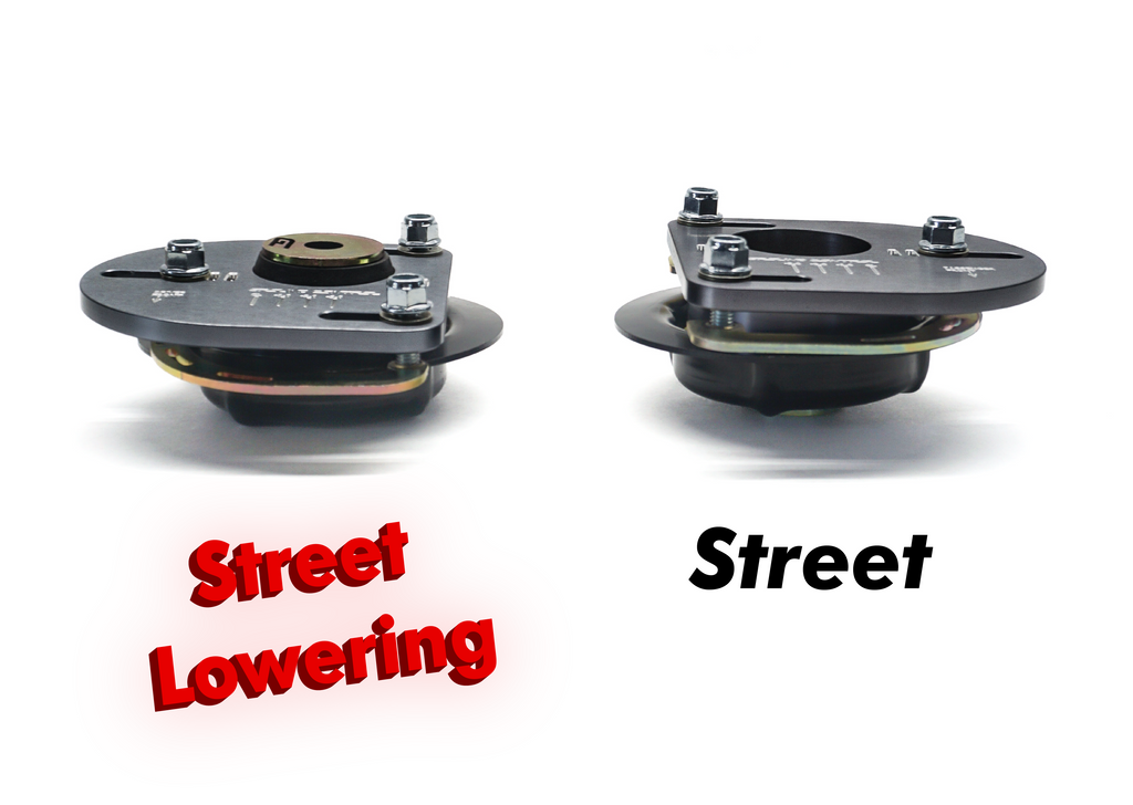

      GC street camber plates can be used with stock style springs and are not solid mount. I've been running them on a few of my cars, perfect OE solution to get a better alignment with no noticeable increase in NVH. Plus much cheaper than the stock hats (yikes!)
      Just saw there's also a 'lowering' version now..
      Click image for larger version  Name:	DSC02711-Copy_1024x1024.png?v=1713890604.png Views:	0 Size:	360.9 KB ID:	322937
        Cool to see them rework the plate for thinner stack. Wish they made it for E90, just bought the regular street plate. Still nice.
        I would def go with these for e46, or TMS.
