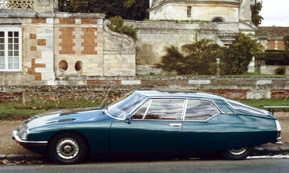

    Sat for 8 years and not moving the brake pistons then for sure some of the seals are damaged. Oil seal is not the problem, but brake fluid allows seals to bond to the cylinder. The only exception is the brake system on some of Citroen cars which use mineral oil for brake and not the standard brake fluid, i.e. my 1973 Citroen SM.
    Same color but this's not my SM:

      As a French person, I love that car. Some came with a Maserati engine that was quite potent.
