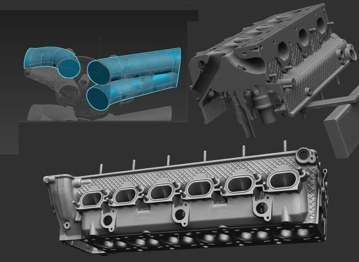

    I'm doing a clean sheet look at S54 header design. Eventually I will put everything up up in a github, including all scans and any cad files. There are many headers for the S54 but ther are are a few reasons I want to look at this again in 2025:

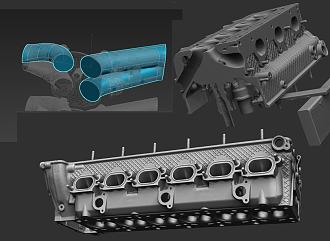

    1) 3d scanning makes more complicated packaging much easier
    2) Additive manufacturing. I have been using DMLS for parts and its reasonably affordable now. I think there could be some cool stuff possible with additive that wasn't necessarily feasible before.
    3) Better informed header choices specific to people's cars and engine builds.
    I have a first scan of an S54 head. I'll be re-scanning for a cleaner result before sharing it but its good enough for the port length and volume measurements I have been using. I have a stock cam S54 set up in Pipemax and I think its getting close to being configured correctly. It's putting out suggested header dimensions. I'll be building this to fit my S54 E36 M3 but I have an e46 chassis here that I can scan as well.
    Click image for larger version  Name:	S54HeadScan2.jpg Views:	0 Size:	115.9 KB ID:	323894 Click image for larger version  Name:	SoutingScan1.jpg Views:	0 Size:	73.8 KB ID:	323895

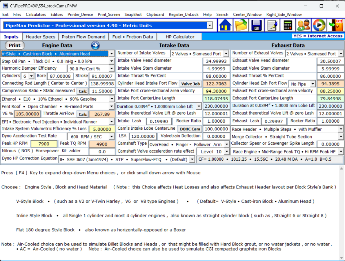

    Pipemax as it is currently configured for stock cams:
    Click image for larger version  Name:	Screenshot 2025-10-23 183127.png Views:	0 Size:	746.5 KB ID:	323896

    My current pipemax config for anyone who wants to mess around with it

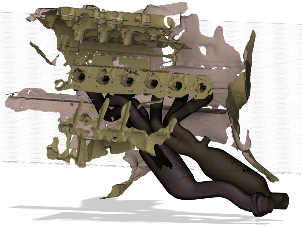

              It would also be great to include the E36 chassis in a scan for header design, as the differences are very minimal.
              With this, the headers could potentially be made to fit both chassis.

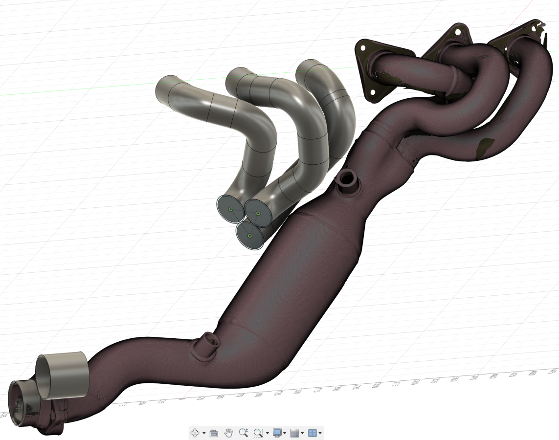

                Good thread! Not being constrained by what can be done with bent tube should allow for some meaningful improvements over what's out there now. Port match flanges that transition well, exactly equal length, easy install, optimized steps at equal distances, cam specific should all be viable!
                ... if outside of my skill set
                Just to get people excited for what can be printed for about the price of a set of high end headers these days:

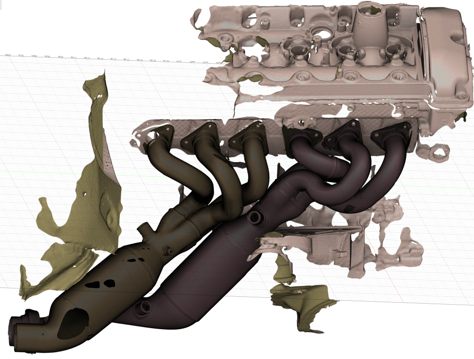

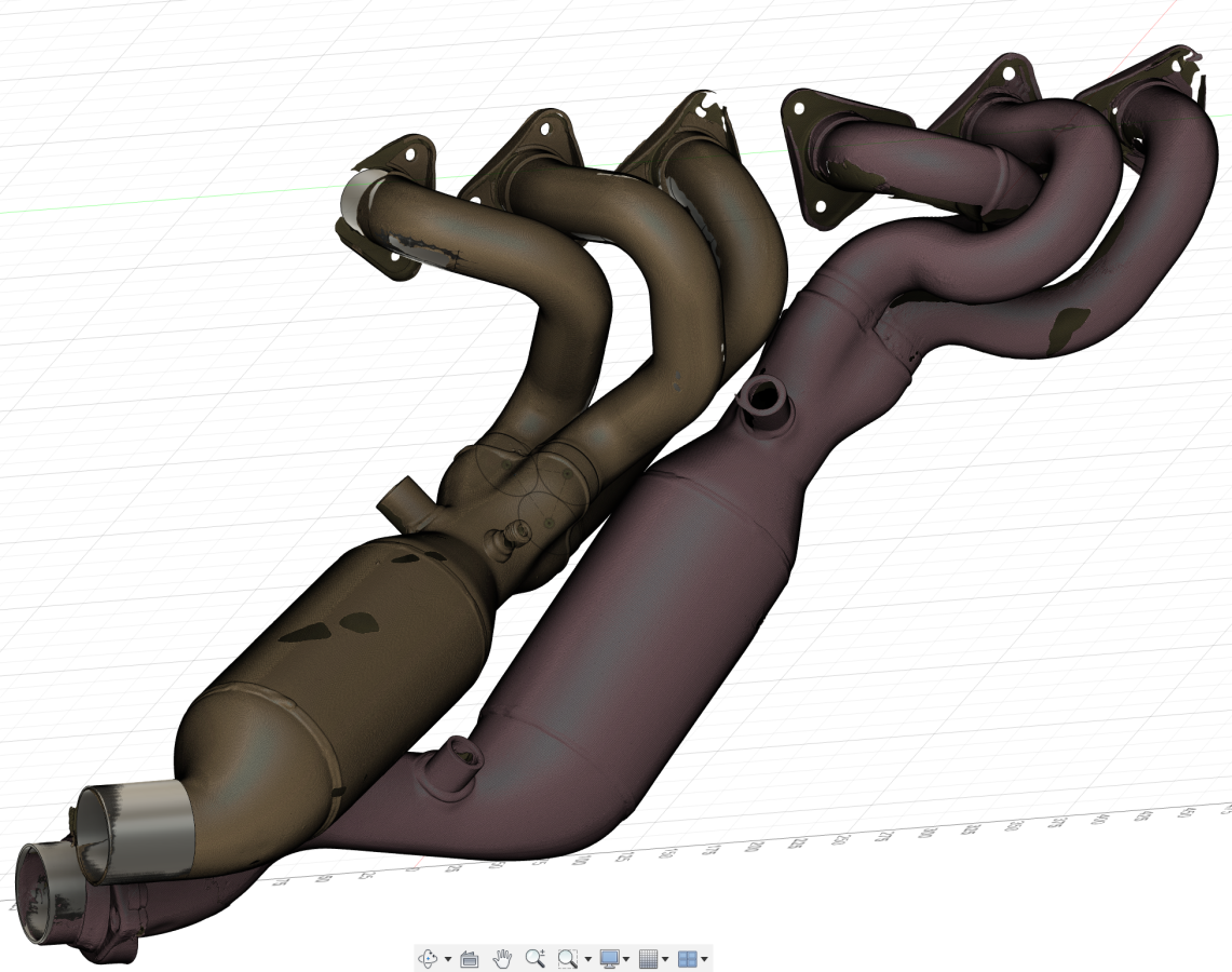

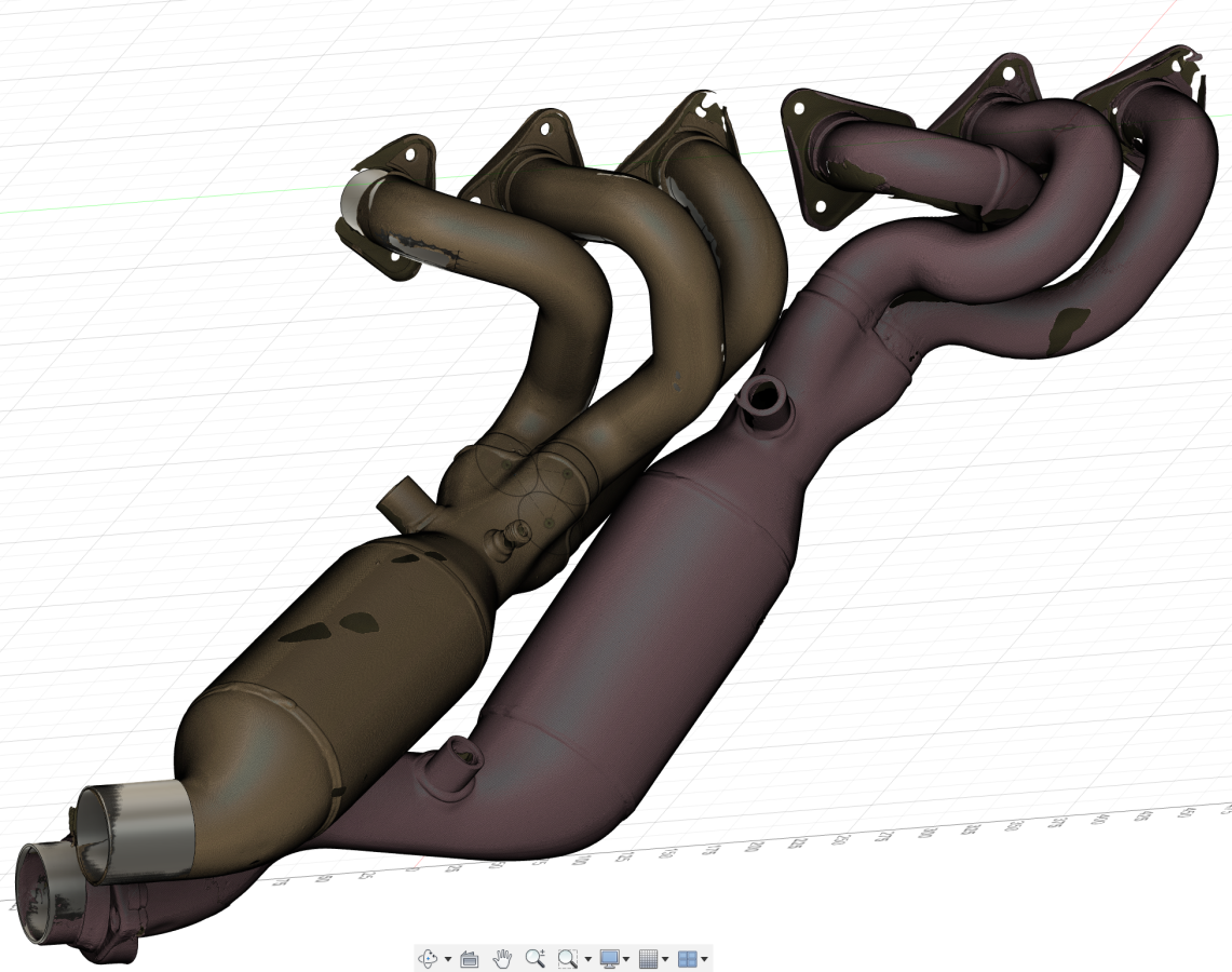

                    I saw your posts on FB (and offered a head to test), glad you are bringing this info to the forums too.
                    These are what I am messing with right now. Kromer Kraft headers, originally designed for an E36/S54 but I'm adapting them to the E46 chassis. Kromer was developing this system (and M54/S52 options) in mid 2000s. Time has marched on and there may be better options now but back then they were up there as something you could purchase for an all out car.
                    6-2-1
                    Measured #6 primary, it has 2 steps - 44mm to 47.5mm to 49.5mm od (roughly), lengths are 7", 9" and 8".
                    The 2-1 'Y' necks down to 60mm od
                    I had these on the car 4 yrs ago but pulled them off before fully developing the setup. This was the first dyno and tuning session with them compared to another car same day, same dyno.
                    Blue is my car - S54, GS6-53 trans, KK Headers, HTE Tune, Karbonious intake, Alpha N
                    Red is a clients car - (ZHP) S54, 420g, Euro headers and cats, Supersprint conversion section 2 & 3, stock intake, stock Euro tune
                    I'm getting them fixed up and are going back on the car this year.

                      That's really good info. If I take my pipemax config and up the VE to get something like 370 crank (reasonable proxy for 340whp?) I get suggested header ODs with 3 steps of 42.7mm, 46mm, and 49.1mm. That's assuming 16 gauge tube which is most common. It wants a total primary length between 545mm and 636mm. These numbers are really close to that header. The range of primary lengths are also impacted by how I set the lobe separation and how that impacts overlap but that's the ballpark length. Also pipemax wants the 2-1 merge/x pipe/ collector length to be 980mm from the merge. I wonder what would happen if you moved it back.

                          The super sprint V1 headers are unfortunately very much not equal length, so you may have trouble simulating their output. This is what I run in my car and has had me dissatisfied enough that I ventured down the path of designing my own 3D printed/mandrel bent stepped headers as well. But my 3D printed suspension knuckle project has pulled me away from the project
                          In any case, I have decent scans of an e46 engine bay and an s54 from George Hill's spare front clip and motor. I've also got scans of the US headers (important note that the banks switch sides L-R on US headers for packaging reasons), but haven't scanned euro headers yet.
                          The US headers (which I'd wager are similar in length/diameter to euro) runner length is approximately 246mm by my numbers after remodeling the header to fit, and I measured ~70mm for the exhaust port length, although my scans were not great for this. Your data looks way better. If you shoot me your email, I'll send you a link to my Fusion CAD file, which contains scans of the chassis, engine, and both headers, plus has bank two runners modeled to match the header.
                          The runner tube is 40mm OD, 1.5mm wall (37mm ID) and all bends in bank 2 are 40mm radius.
                          Hope that helps for now! If you're working in a CAD environment that allows simultaneous work, I'm happy to help there as having another person work this is providing some extra motivation to get back on the horse.
