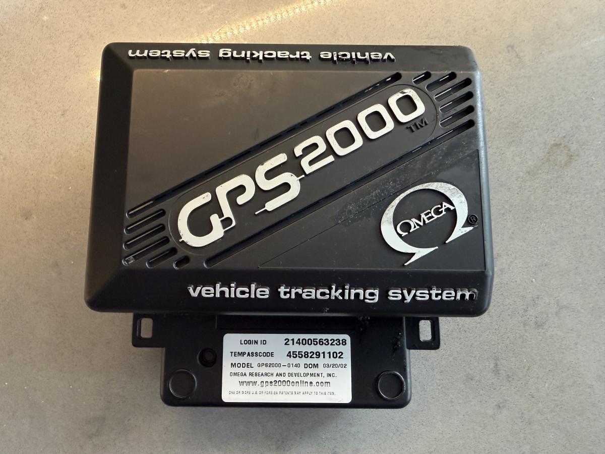

                  TBH I found it by accident. I removed the trim panel under the steering wheel so that I could remove the dead pedal panel. When I did that, I saw a white zip tie sticking down. I was pretty sure that wasn't original to the car, so I climbed under the dash and found the tracker wedged up in there.
                  The tracker is an Omega GPS 2000 with a production date of 2002. Can't find anything about it online, except by searching through the wayback machine/internet archive. Omega's current offerings ( https://www.omegagpstracking.com/ ) include a product that sends a ping every 10 minutes. That's exactly what I believe this unit was doing. I am further speculating that the battery in the tracking device died, and that is why I was getting the beeps from the cluster. For sure the beeps didn't start the day I took possession of the car - really nice of the previous owner to be up front about it :/
                  My guess is that it was installed by either the BMW dealership that originally sold the car in August 2002 or by the second owner (early 2006).
                    Did you try the login info on the label? 🤠
                      Of course I did! Website is dead.
