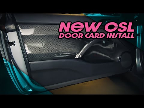

        Fast forward to 13:08 if the link doesn’t jump to it:

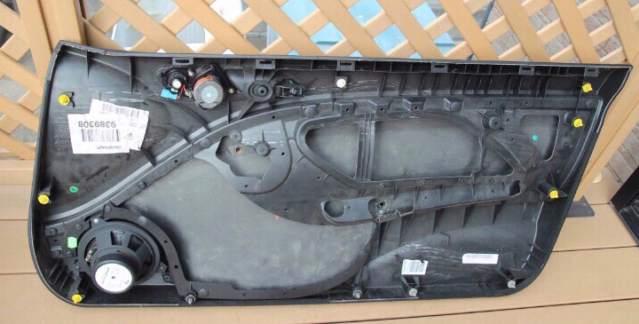

                      I have done zero research on this, so take this as thinking out loud rather than vetted advice.
                      Couple different options:
                      1. Use a short but fat screw paired with a washer, screw from the backside of the panel into the dowels that come off of the leather panel.
                      2. Drill a hole into the dowel that comes off the leather panel. Use a matching sized plastic rivet with large head and rivet the two together (I believe this is how the CSL does it, but I have not seen the panel in person)
                      Click image for larger version  Name:	IMG_2656.png Views:	0 Size:	510.4 KB ID:	324356
