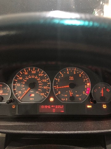

      Oil temperature is always a bit to the left of the center, if that is what you are talking about ?
      Water temperature is in the middle usually.
      This is when driving normally, not hard.
      This is pretty much the normal needle position :

          I meant water temperature. My oil temperature looks just like in the photo.
            Your car is fine. The coolant temperature is fine as long as the needle is between the 2 dots, it does not have to be right in the middle.
              I think there are different temp thermostats floating around. So you might have a thermostat that opens at a slightly lower temperature. This will slightly increase fuel consumption. You do want to get the oil temps up to 212f or 100c frequently since that helps keep the moisture out of the oil.
              Or could have the bypass in the oil filter housing blocked. Common thing for an E46 which sees track time to have.
                If you aren't getting the 105 DTC for temp implausibility. I absolutely wouldn't worry about it. Maybe you just have a very good fan clutch
