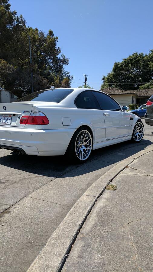

              I run Et35 front and Et22 rear on 18x9.5” ARC8s. By far it’s a better setup than Et22 squared. I used to run Et22 squared but 3.4+ negative front camber in the front is to much for mostly street/back roads car. With Et35, I am able to run 2.8 degrees of negative front camber.
                ^^this is what im looking for. you mind posting some pics? i guess depends on your height, do u have to work those fenders?
                thank you.

                  No fender work. I don't remember the exact number but I think I am around 13.5" or so front and 13" rear.(car is on jackstands so I can't measure right now)
                  These are a few pictures that I have of the M3 with the current setup.
