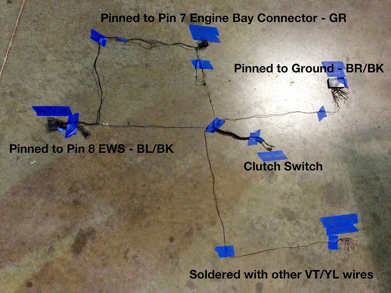

How I wired up my 2002 M3. Donor wiring was pulled from another MK20 M3 and I looked at the differences and traced where the wires go. My M3 fired right up after this, all I needed was programming that was done via Autologic.
