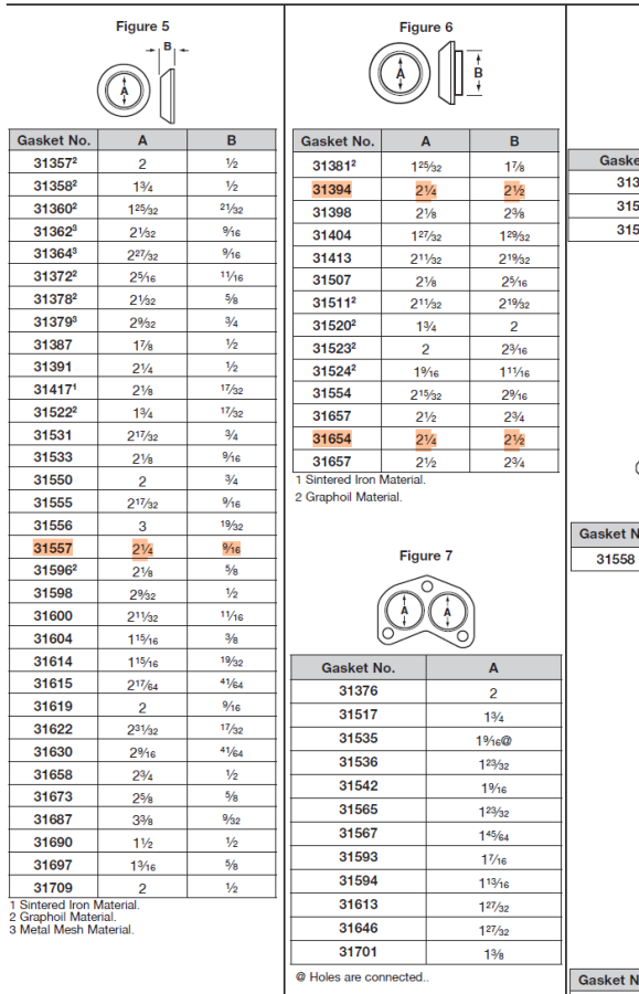

I've got a car in my shop that has aftermarket headers (I do not know from whom), the issue is the outer (B1) header collector is 56.5mm od and a stock gasket will not work. For reference the inner (B2) uses a stock gasket and is 53.5mm od. You would think the 3mm wouldn't make a difference but it absolutely does and I destroyed a genuine gasket and even an HJS trying to fit them on.
I can't find any reference to an oversize gasket anywhere but surely I can't be the first one to come across this and its a simple I didn't search the correct key word. Can someone help me out here?
