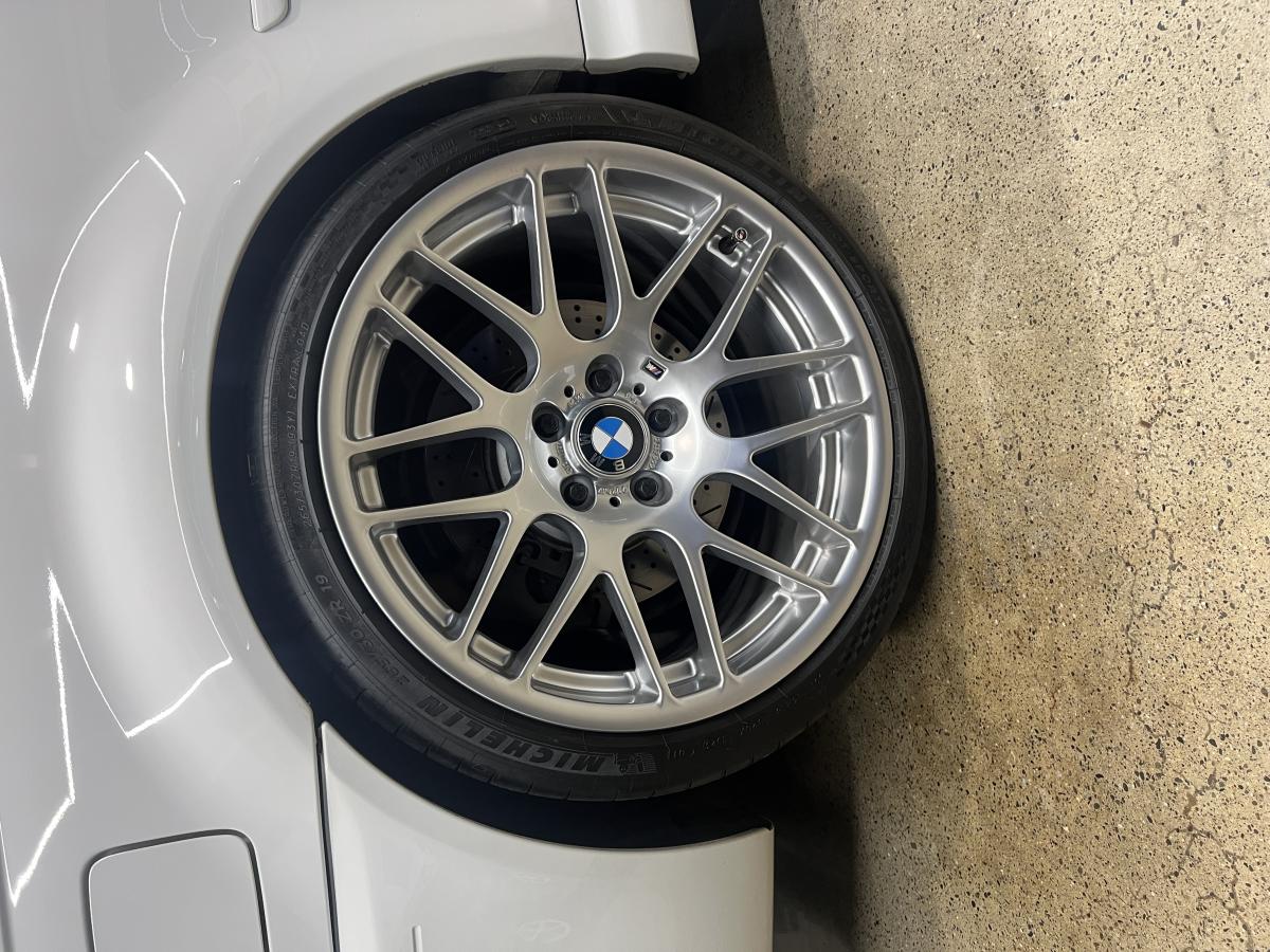

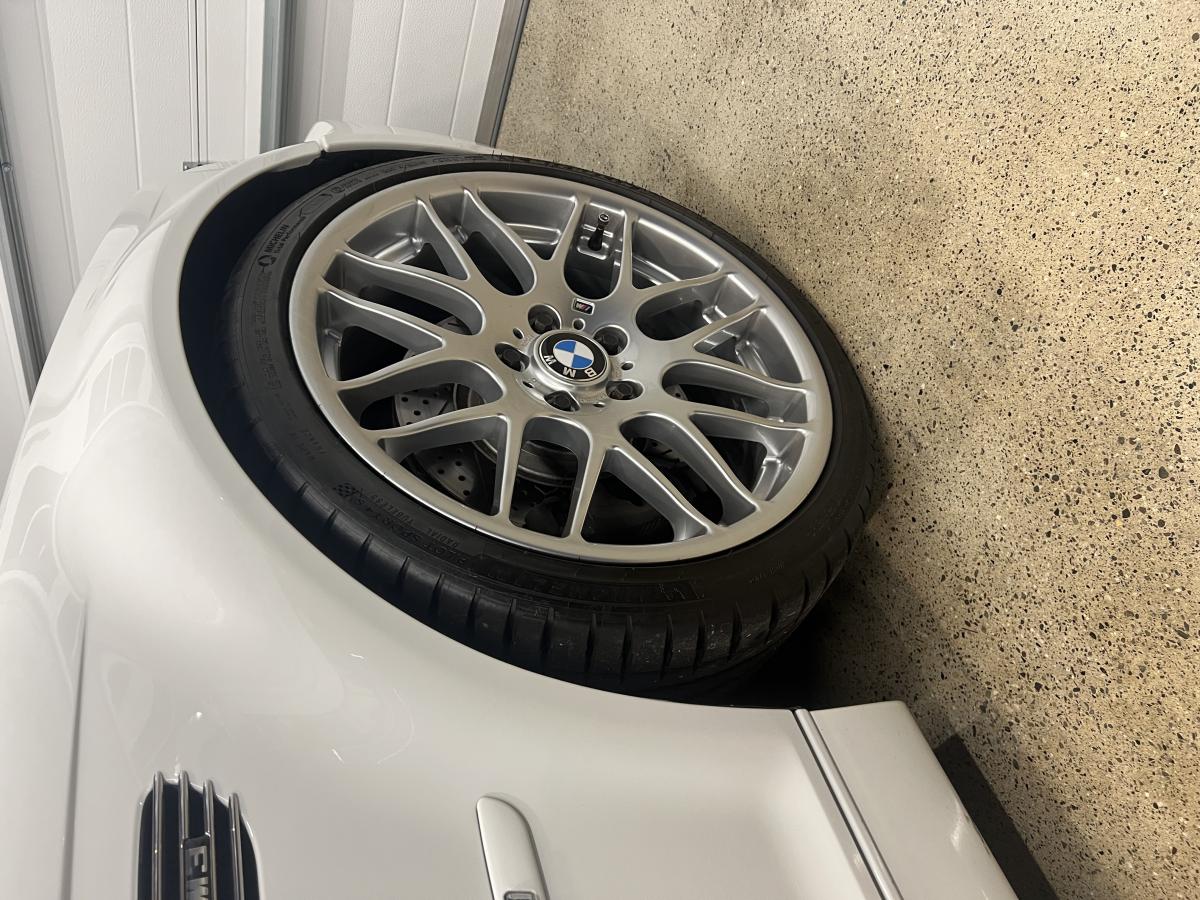

                    I have Koni yellows and H&R sport springs so will chime in here. Fronts are about a 2 finger gap and the rear is a little smaller at about 1.5-1.75 finger gap.
                          Do you find that the front left is a bit higher than the front right?

                            Just measured and both fronts are sitting at the same height.
                            And thanks, it’s been 10 years of dialing it in!
                              MotorSportThree Overall ride height should be noticeably lower than stock with H&R sport springs. Personally I think it's the perfect ride height. I also have 15mm front and 10mm rear spacers to help with the stance. I will say this setup can bottom out from time to time but overall pretty compliant. If I had do it over I'd go with Ohlins R&T. Maybe bump stops were installed incorrectly?
