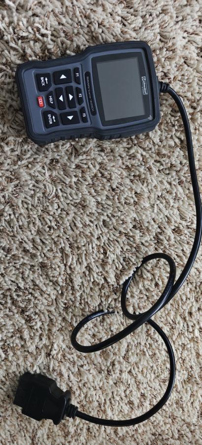

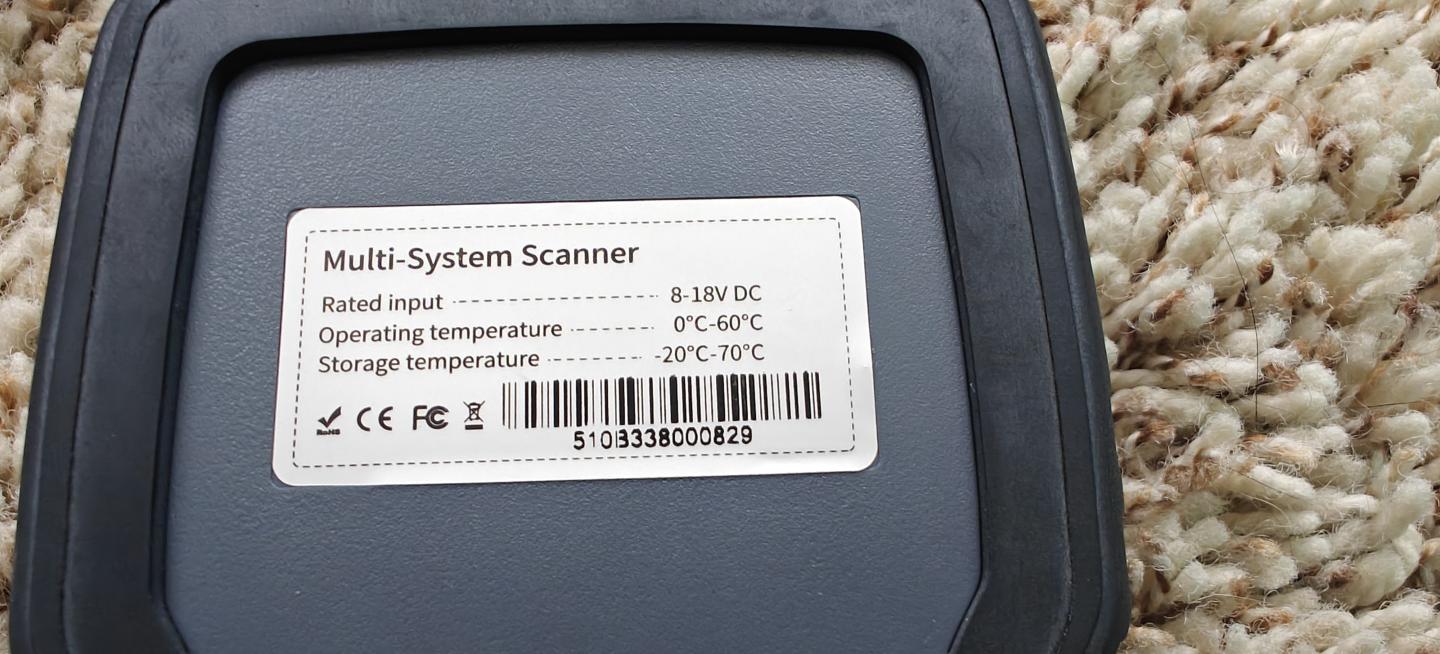

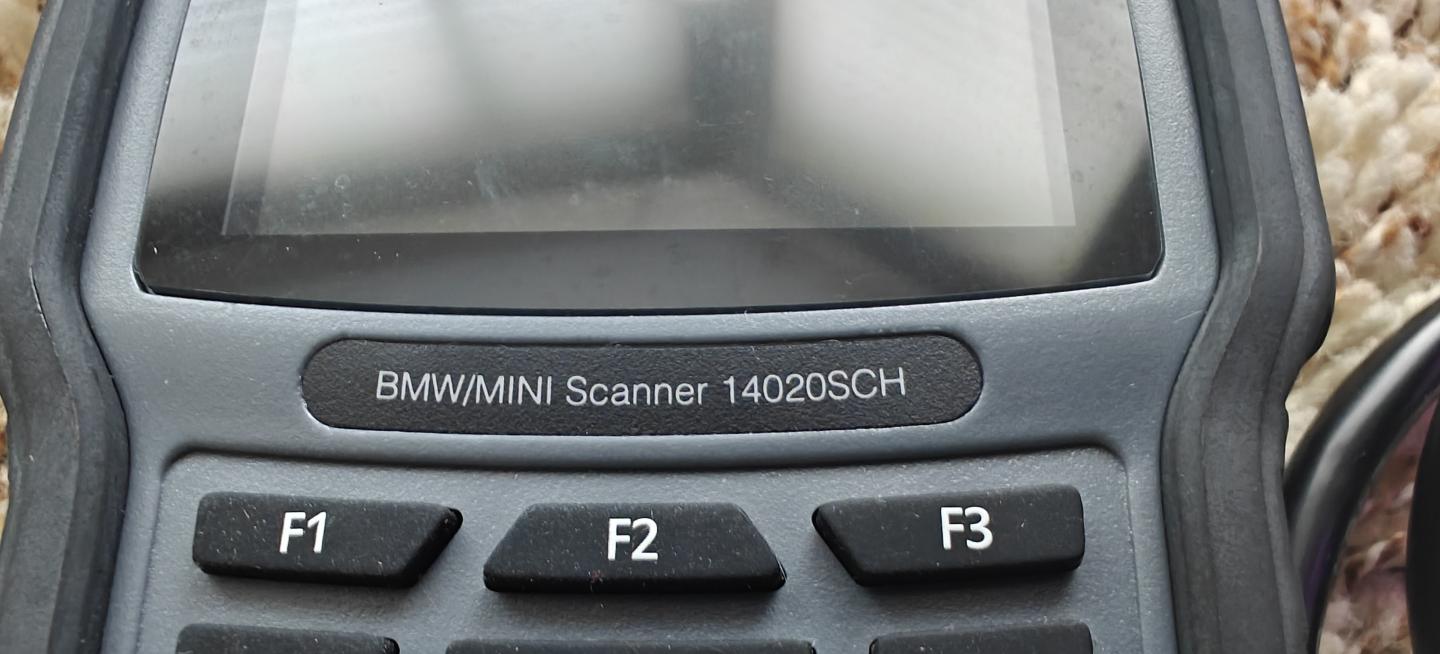

    I have this one, IDK if that'll hep you. I've never had to update it.
Name:	2025-12-03 09.59.41.jpg

      Right, I'm specifically asking owners of that tool, who HAVE updated it sometime between 2019-now, to please take the data off the sdcard and send it to me (or host it somewhere for others).
      To be fair, I'm not even sure this tool got updated with G series cars, but I'd like to give this experiment a shot.
        Well I bought mine in like 2022, wouldn't I have the files you need?
        IDK if I even have a freaking mini USB anymore, let me see if I can find one.
