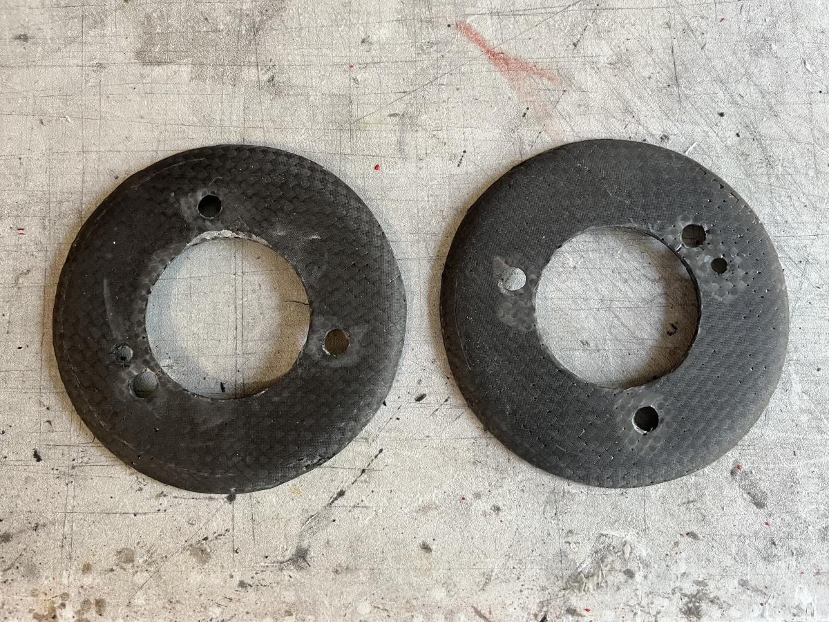

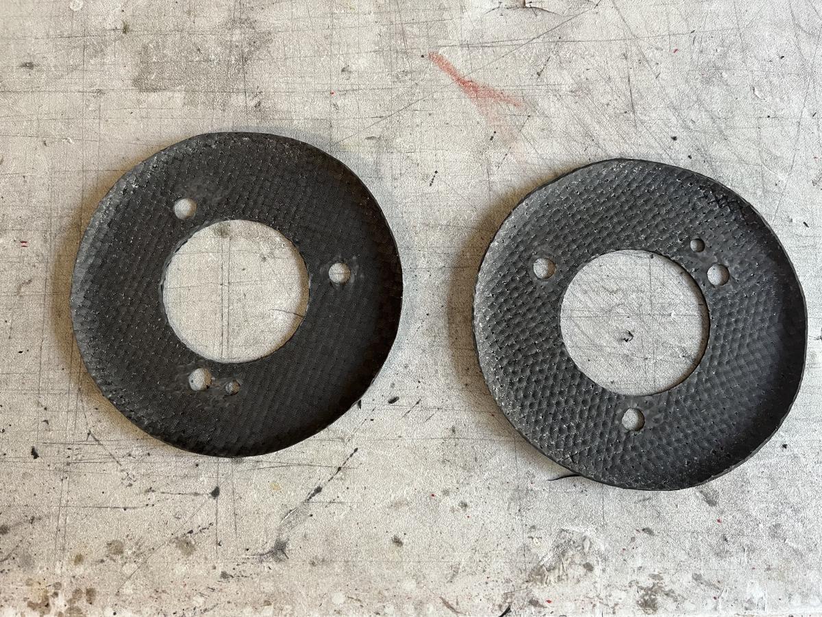

        I bonded my carbon plates in. I occasionally change out the front springs and the reinforcement plate makes the job an exercise in fumbling around.

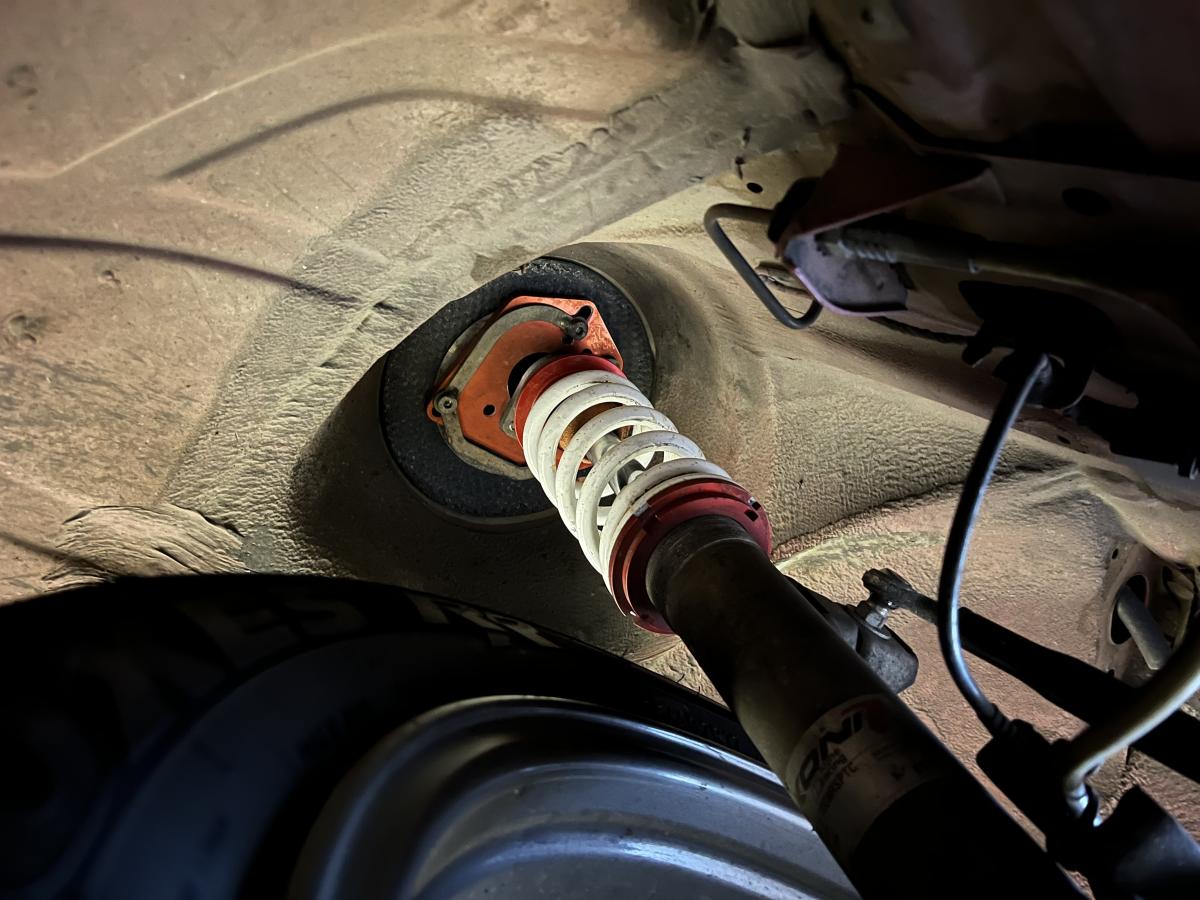

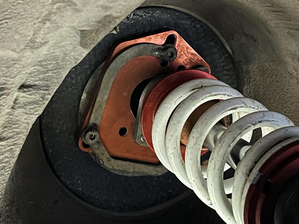

          Cubieman​ what front camber plate / strut were you running up front? I've got Ohlins R&T and an older GC street camber plate the PPO put on, no reinforcement plates. A little worried when I take them off soon to put on my MCS 1WNR (bought the reinforcement plates)!
            It was BC'S/BC plates/reinforcement plates. No idea how long they were installed as it was one of the 3 previous owners. Definitely closely check, I had to remove paint to really even see some of them.

              I think I'll be using some 3M to this weekend and sticking these plates to the car. On a side note, it appears you have TCK'S/Vorshlags like I do.
              I didnt exactly know what the red anodized concave shaped "top" pieces were for that came in the box, does that ring a bell and if so what do they do?
