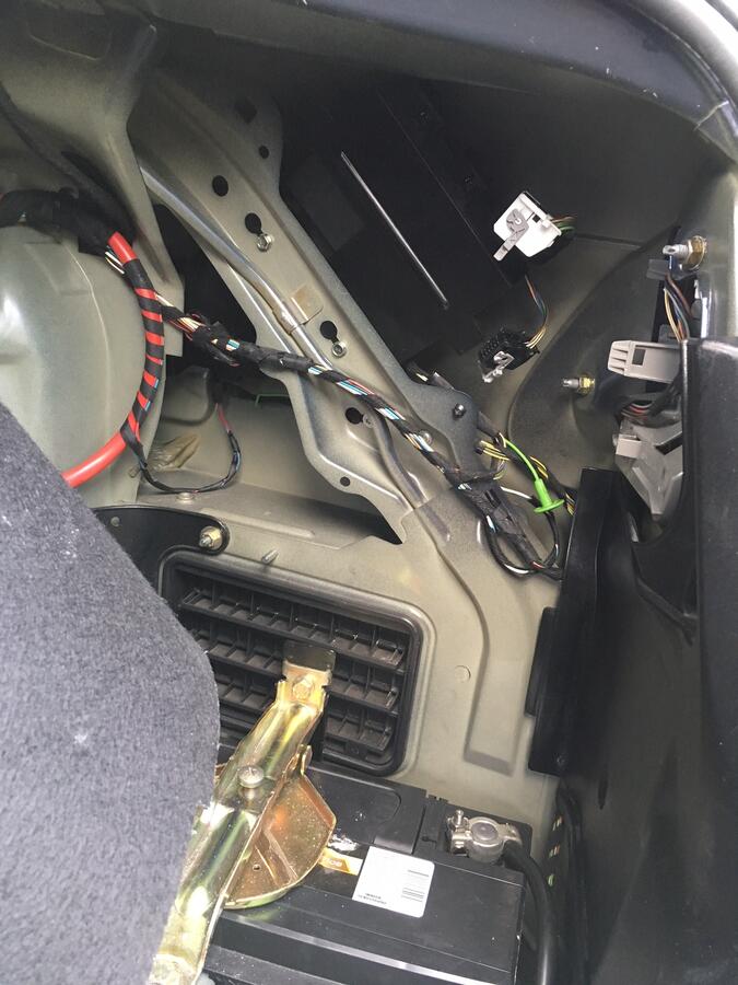

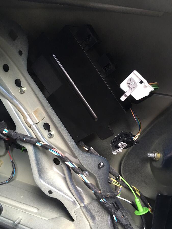

    Ive been hating on my PDC for awhile now and was looking for a way to disable the thing permanently without triggering any error codes. For some reason this was really difficult to find in the forums. And of course it was embarrassingly simple.
    Go to your trunk and disconnect your PDC module from the main system. The module is located right above the battery in the right side of your trunk. Simply pull back the trunk sidewall lining to expose a black box with two cables attached. I believe one goes to the main ECU and the other goes to the sensors. Just disconnect both of them and youre done.
    If you disconnect just the sensors from the module then the codes kick in. However if you disconnect the module itself from the main ecu then its as tho it was never equipped from the factory.
