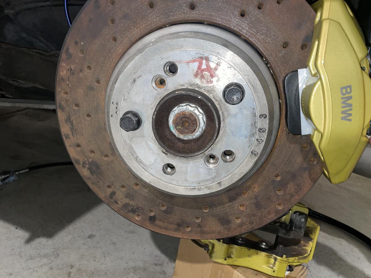

    Working on my rear brakes, I took a very different approach than most.
    it keeps the spirit of a parts bin special BMW used for the Z4M 🤪
    e9x M3 rear rotor
    e82 135i rear caliper
    F8x Rear pads
    First fit test shows it all lines up nicely, however is not a plug and play affair, needs some work but is not too difficult.

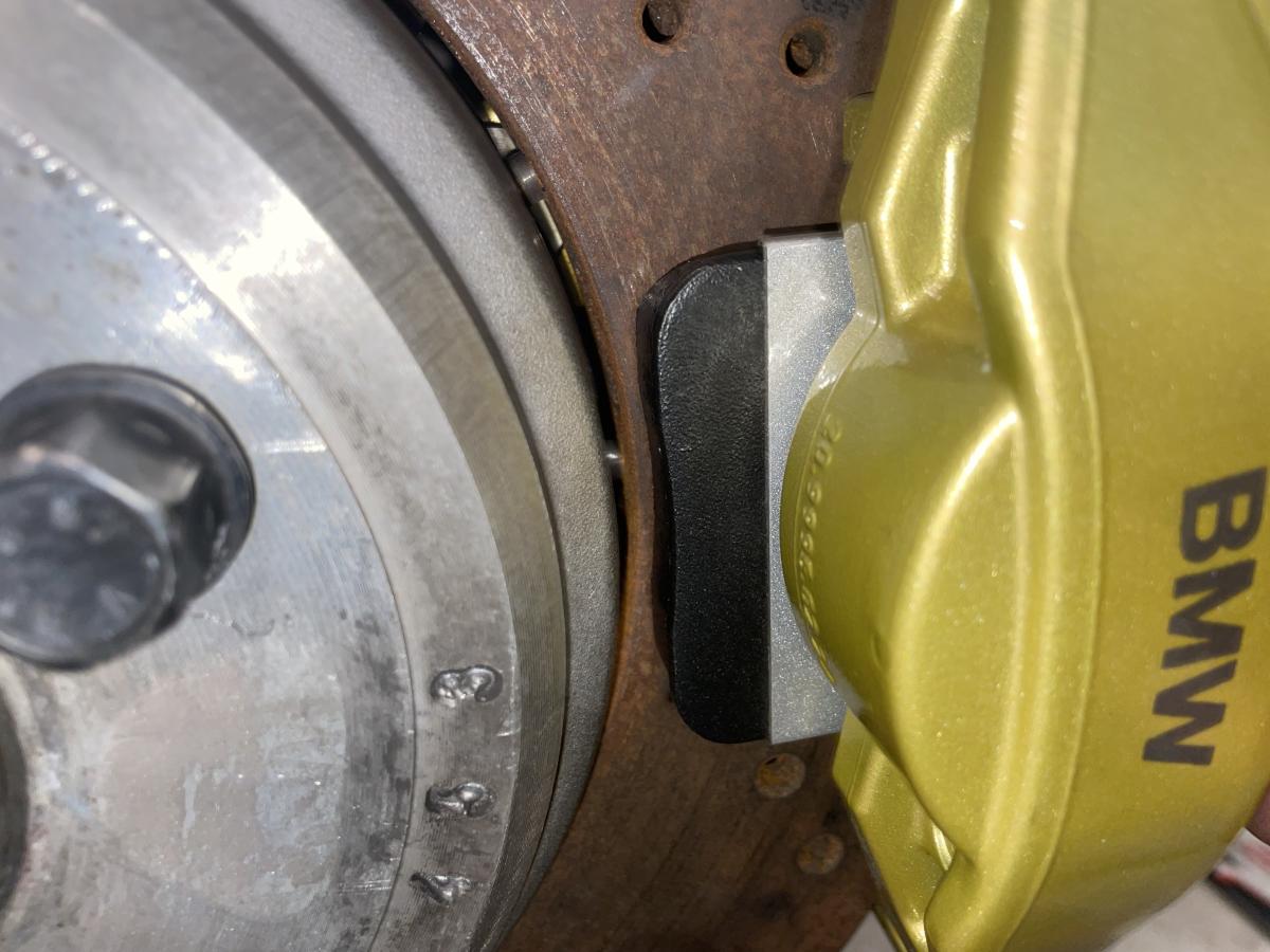

ID:	338182 The pad aligns nicely with the outer edge of the rotor

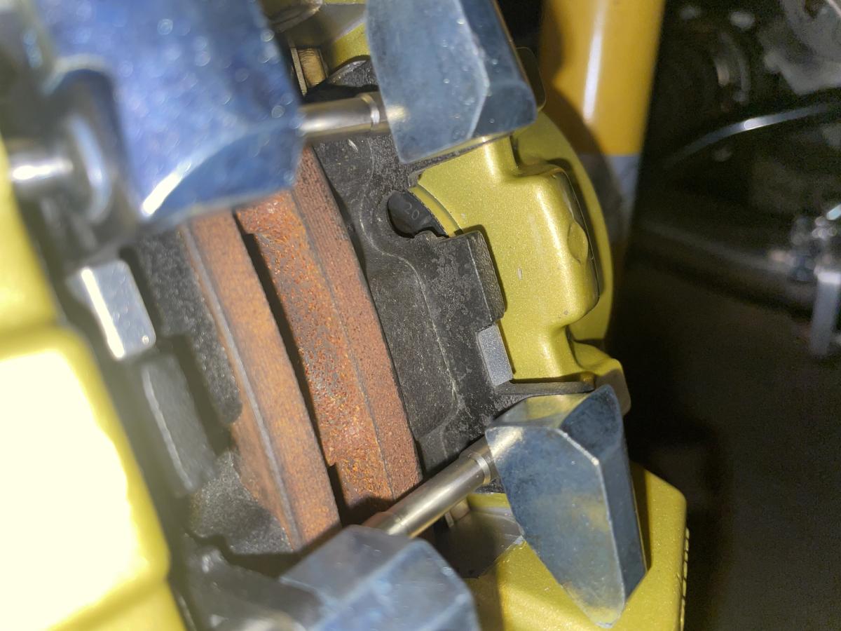

    and it sweeps like 98% of the rotor.
    Click image for larger version  Name:	IMG_2836.jpg Views:	0 Size:	112.4 KB ID:	338183
