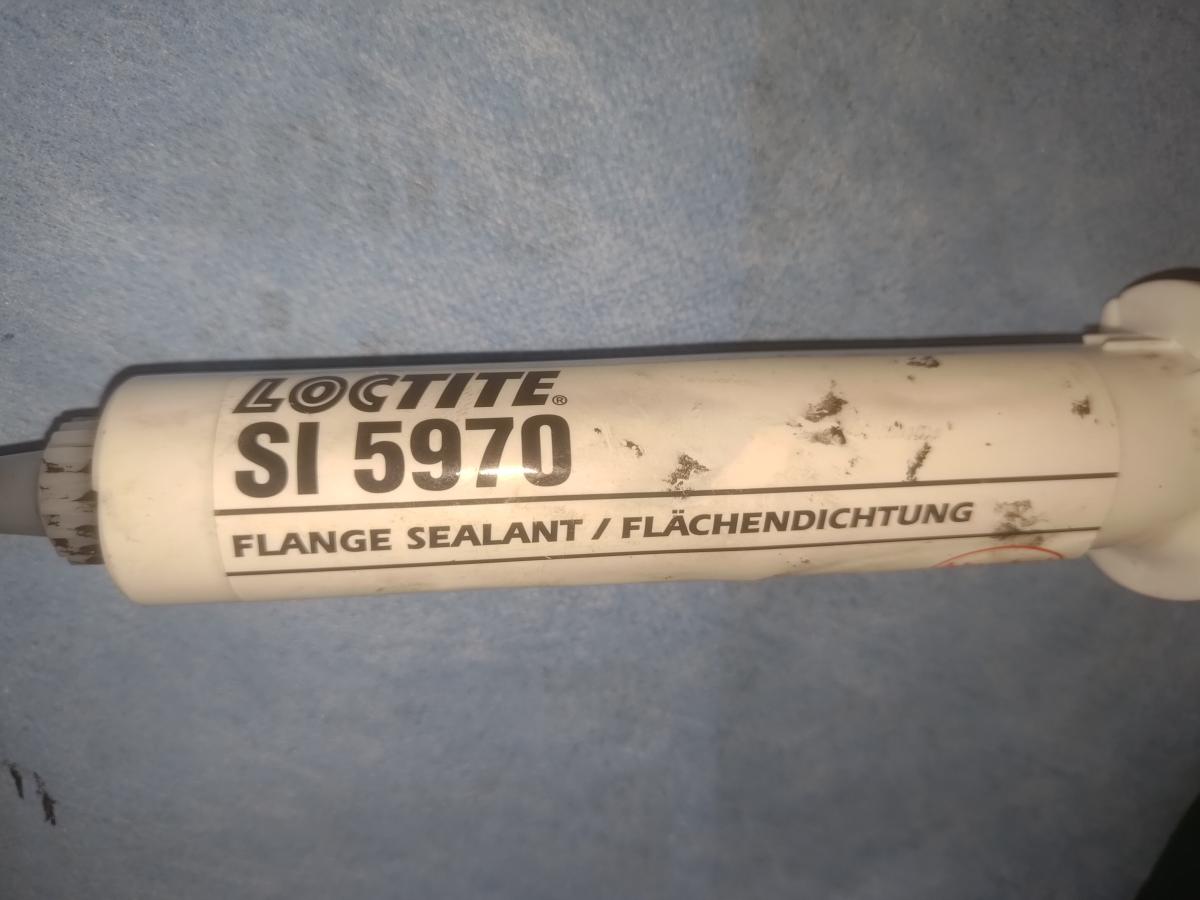

      Click image for larger version  Name:	P_20260121_195849.jpg Views:	0 Size:	76.1 KB ID:	340809
      I ordered dreibond from bmw, they sold me this
      Is it on par with FIPG?
        Yea, thats it. I am partial to FIPG just because of the packing, its in a traditional "toothpaste tube" type container.
        In your case with the vanos deal just use your finger and put on a light coat around the permiter of that bolt hole area and also were the vanos mates to the head up top.
        You can also put some in the "half moon" divots on the rear of the head, but those are a bitch to clean out the next time.
