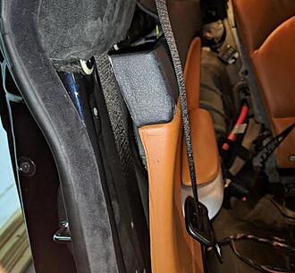

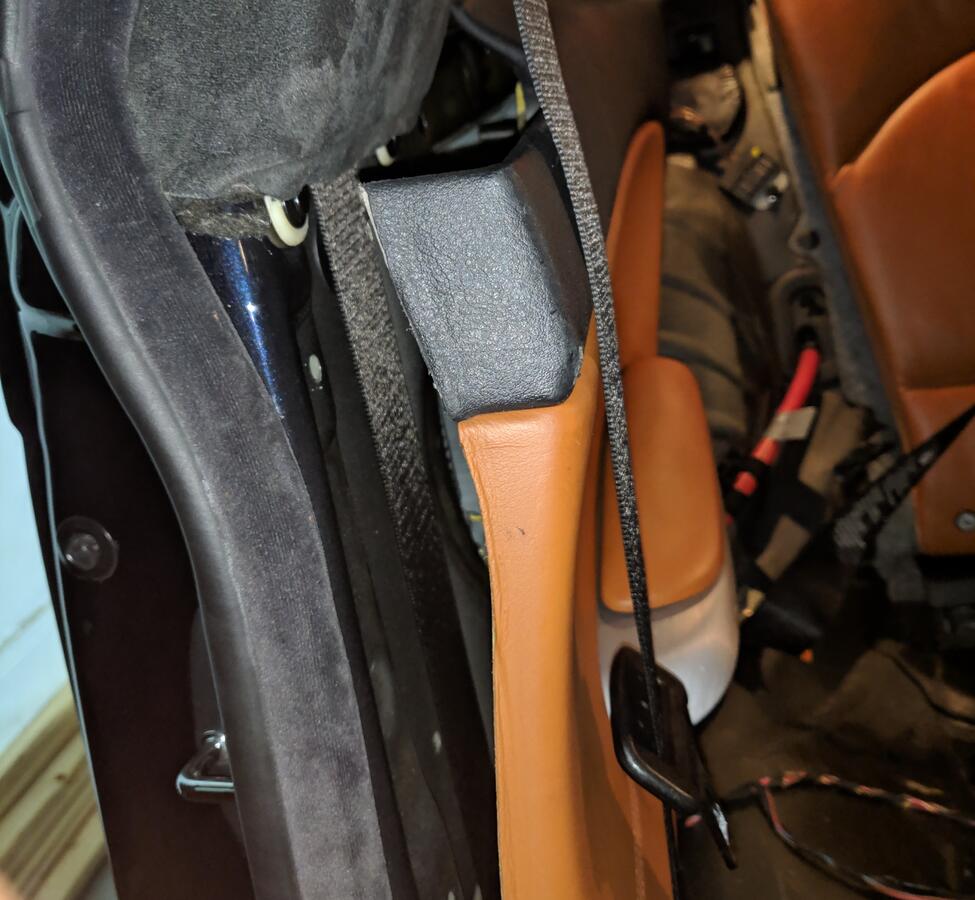

    I know this sounds basic but i'm struggling here.
    When I was removing the B pillar covers to upholster them I saw the door card in the rear was hanging off. When I tried to pop it back in it kept coming out just to right of the B pillar cover. I figured it was just old clips so bought new ones but still no luck. Is there a technique to this?

    Make sure all clips are properly inserted. You most likely have one clip that is not inserted all the way that is keeping the panel from seating properly. You also need to make sure the door panel is tucked under the felt trim on the top and side before you push the panel all the way on. I use a flashlight and take a look all the way around to make sure the clips are in place before I push the panel on all the way.

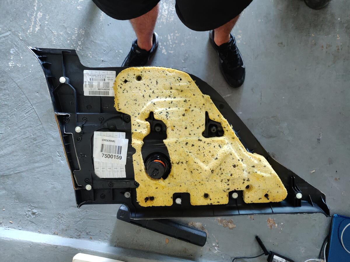

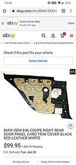

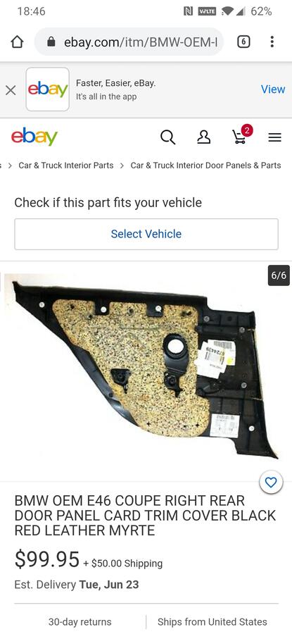

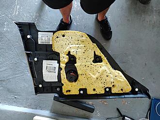

ID:	34244 Thanks all for the input. I've ordered the grey and new style clips to see if it helps as otherwise it's just not working. I did take this photo when I removed the panel but given it was already hanging off I don't know if the clip colors are right or make a difference? Realoem is no help
              Scouring eBay for pics of the rear side of door panels and found that there are 3 grey clips in the corner on most. Last owner must've tried to install with white clips only. Hopefully when the grey ones arrive it will be ok
