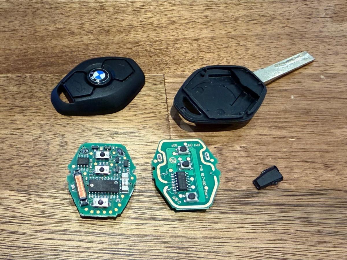

    Click image for larger version  Name:	IMG_8385.jpg Views:	0 Size:	219.2 KB ID:	341081
    Left is OEM circuit board with integrated transponder chip. Right is aftermarket. Far right is the aftermarket transponder chip.

          I found the after market board was rocking inside the closed case and this caused the remote switches not functioning reliably. Does the stock board sit well in the new case?
            I haven’t had any issues but the car is parked for winter so I have only used the keys a few times.
              But don't go with the cheap aftermarket china Transponder. You won't be happy with it for a long time. The first time they work properly, then they get cracked. Had already several of these china Tramsponders. Look for a original NXP Transponder.
                Can you keep us updated as you use the key more?
