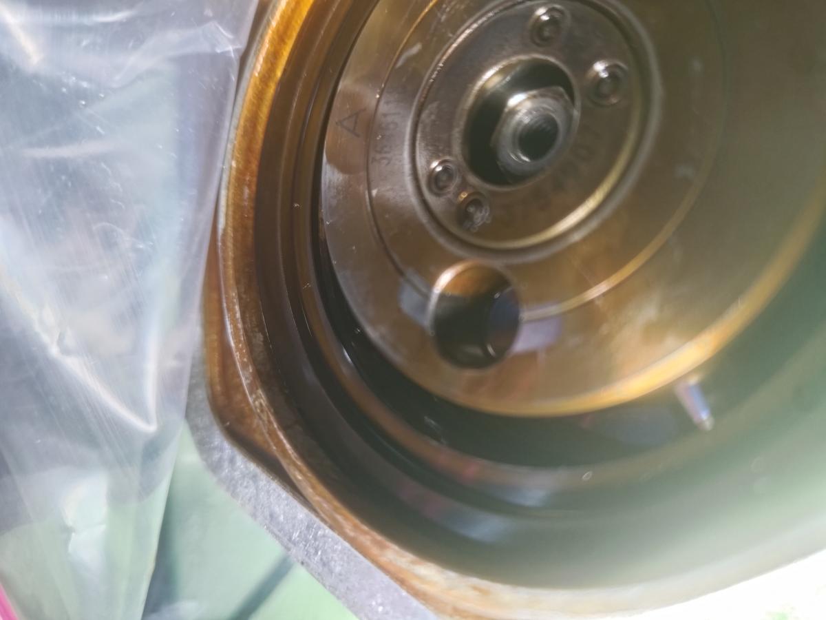

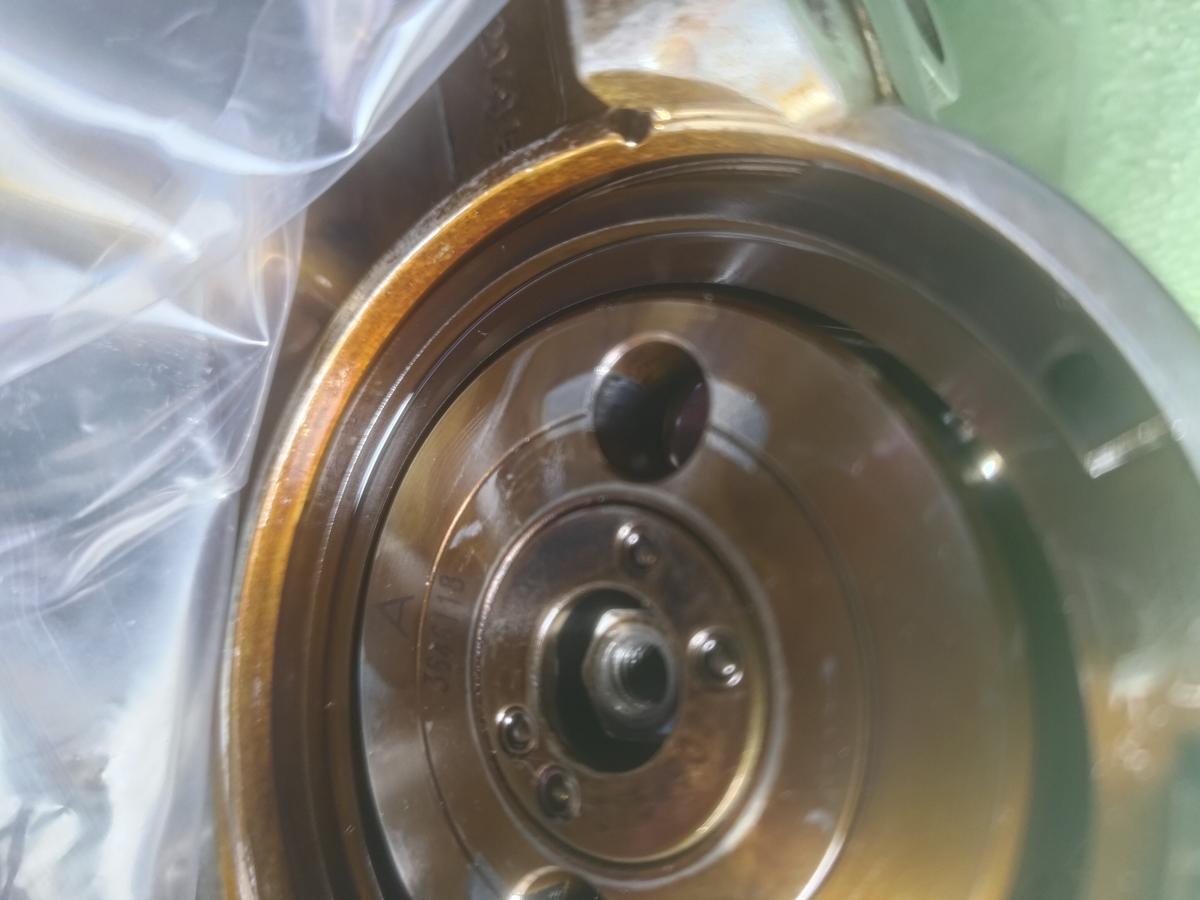

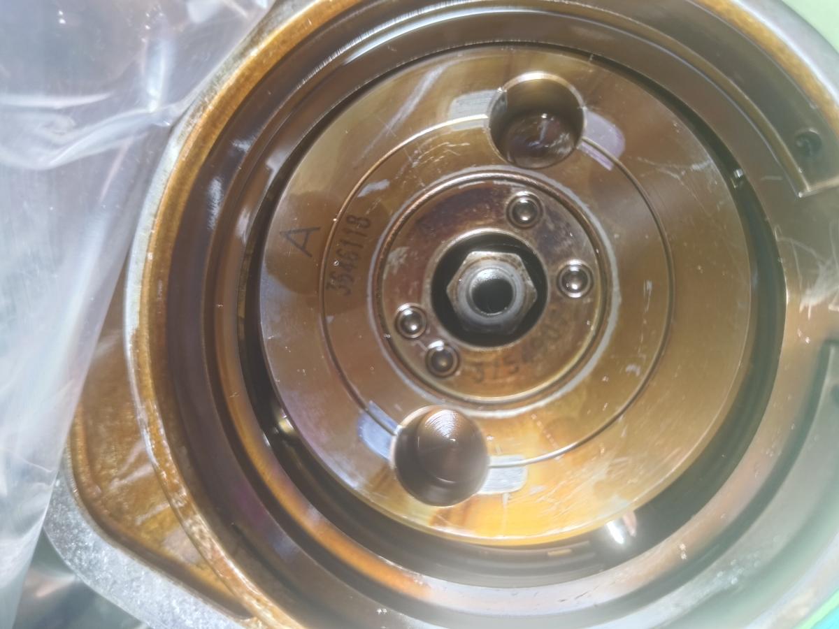

ID:	341620bottoming out issue by the looks of it, holes have increased in depth?

                      It is normal to have those marks. There is some axial play on the components that can make those marks.
