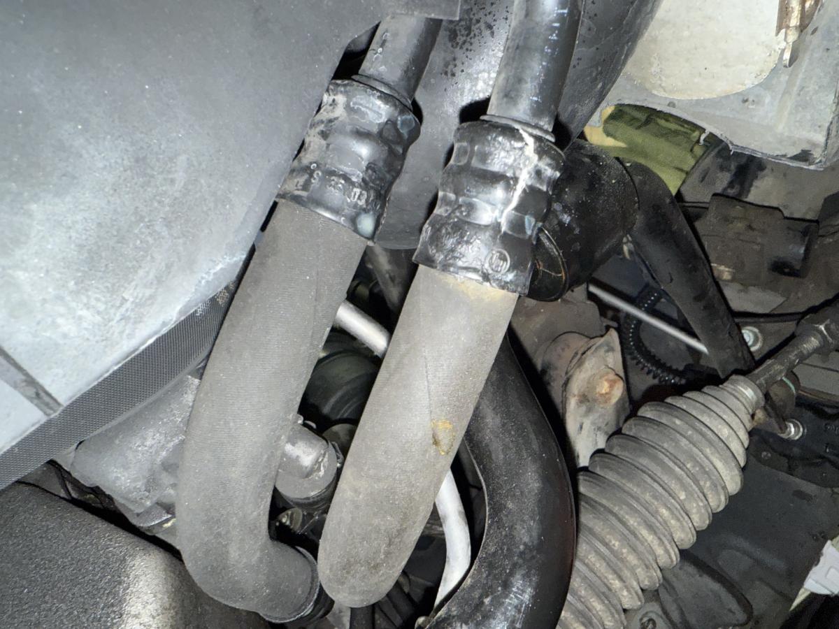

              My oe lines were about to let go at the crimp area.
              The BMW lines were on extended back order last year, so I ended up making up my own an10 lines to a new cooler.
                New lines
