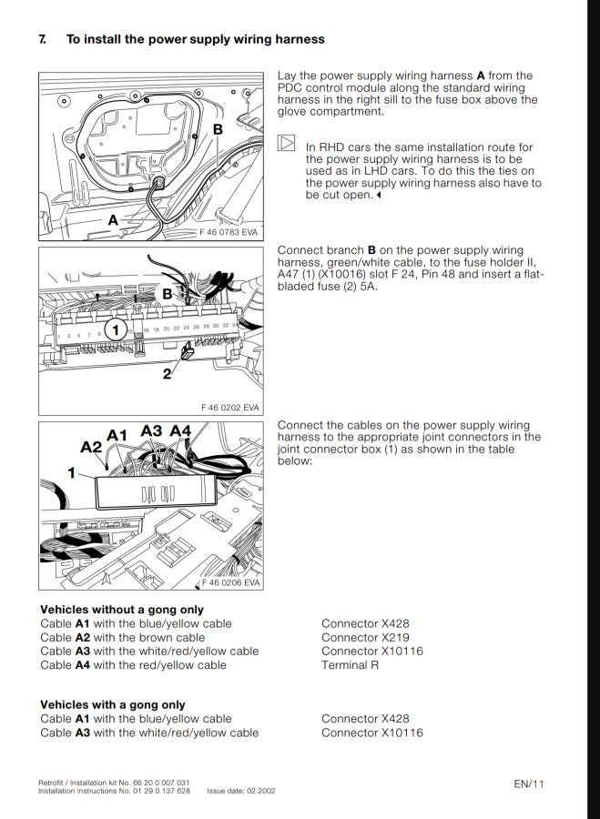

        How did you do the retrofit? Did you follow the PDC retrofit guide? Where did the retrofit come from? Did you get it from someone who cut it out of a car?
        That you wire up all of the wires?
        When you did the retrofit there's two harnesses. There's the sensor harness which is usually intact and then there's the power supply harness plug that's usually cut from the car it came from.
        So the power supply harness plug has several wires. Some of them go to the fuse box. Some of them go under the dash across to the driver side to the gong and the cluster... The important ones are
        Cable A1 with the blue/yellow cable (reverse signal) - Connector X428
        Cable A2 with the brown cable - Connector X219
        Cable A3 with the white/red/yellow cable (k-bus) - Connector X10116
        Cable A4 with the red/yellow cable - Terminal R
        How did you wire those up?
        The k bus and reverse signal and the brown cable get routed to the junction box that sits above on top of the fuse box

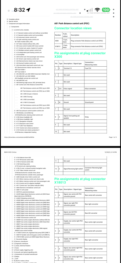

          green white comes on with the ignition and is wired to the fuse. (Pin 1)
          blue grey is straight from (pin 8) pdc to gong (single plug)
          Red/yellow
          and
          brown both also go to the gong from the fuse box and are 12 and ground. Pin 1 and 3
          can bus goes straight from glove compartment to pdc (pin6)
          then brown black is ground for the pdc pin 8
          amd green yellow goes to pdc pin 12

                            I had a lot more wires to run but for the e46 sections I followed this but used the e39 PDC power/comms retrofit harness:
