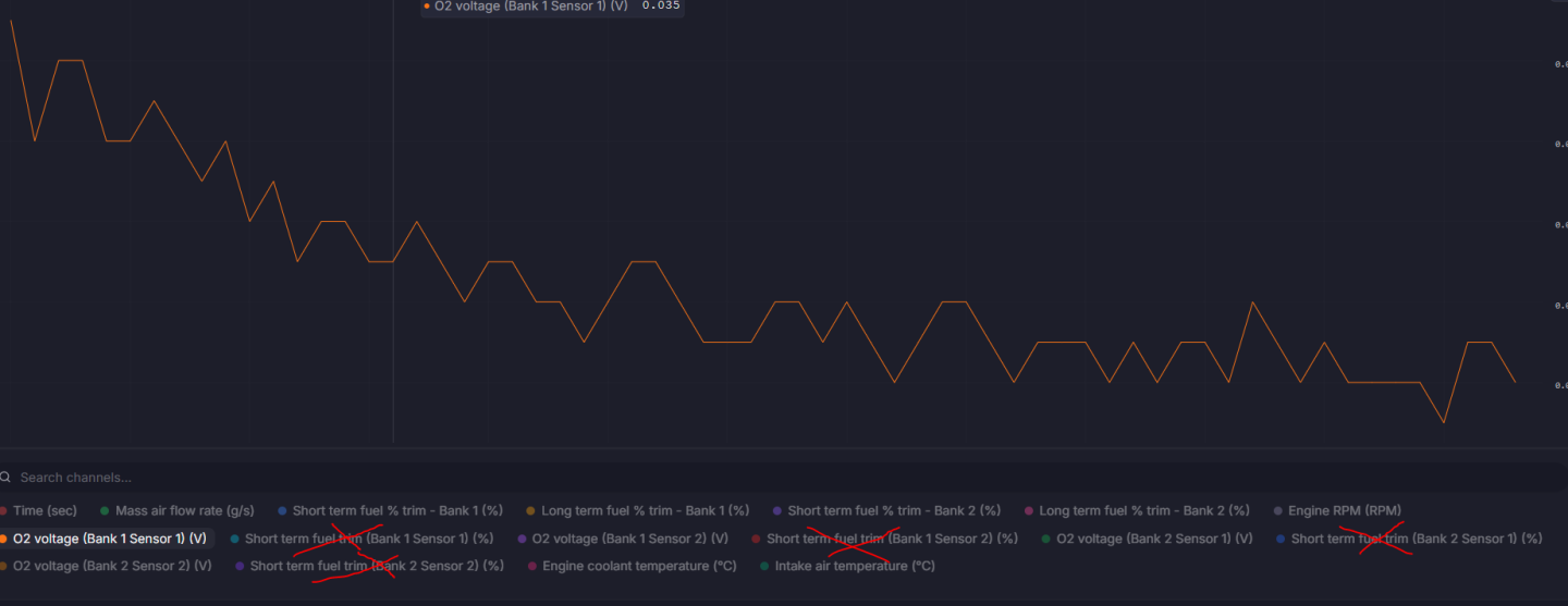

                              I cross out those pid that are not needed.

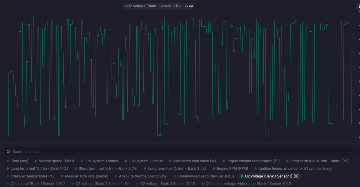

                              All O2 sensor signals look wrong. M3 doesn't use wide-band for pre-cat sensors so I expect to see the signals swing from 0.2v to around 0.7v; Your signals look almost like from wide-band sensor with very little voltage swing.
                              Pre-cat should look like this:

                              Yours:

                                You should add Fuel system 1 and system 2 status pid to the log so I can tell DME runs open or closed loop control.
