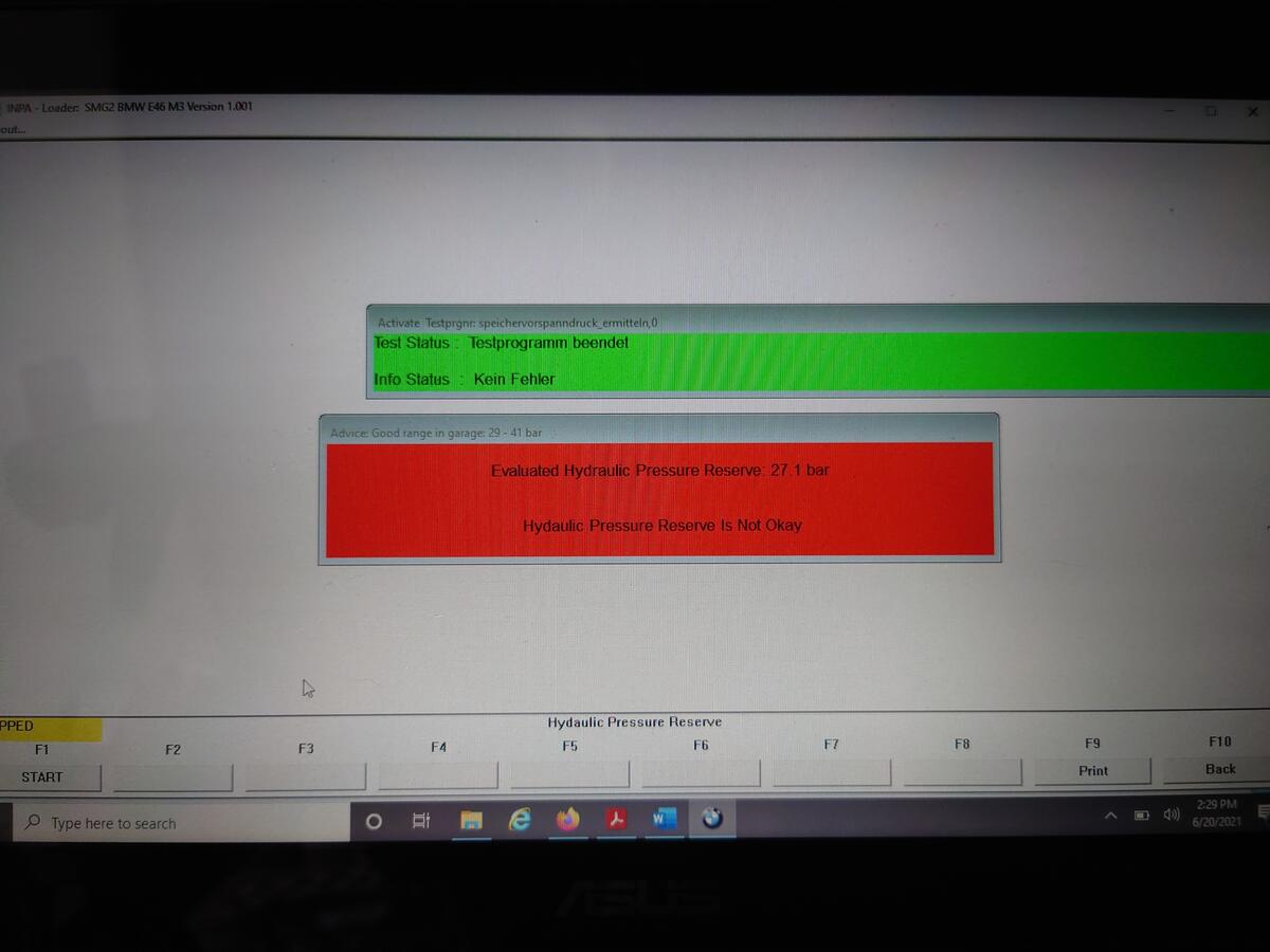

        Lastly, attached is a photo of the only possible issue I can divulge in regards the SMG. I ran the Hydraulic Pressure Reserve and it came up short. This tests gets the same result whether the car is cool and will start or hot and will not start.

          Thoughts:
          1. Your accumulator is not building the required 29 bar during testing, hence the failure you see.
          2. Your car is likely dropping out of gear because it cannot build sufficient pressure. The SMG prevents shifting when this occurs and uses reserve pressure to drop into neutral.
          3. The accumulator could be your issue.
          4. The pump motor could also be the cause. Perhaps age coupled with temperature is preventing the motor from performing to spec.
          5. The seals inside the pump could be leaking, causing the motor to work too hard, which can in turn cause elevated temperatures which could then contribute to number 4 above.
          6. Code 59 is almost always the clutch slave cylinder. But this code can occasionally pop and mean nothing as some have seen this code in combination with relocation and Burkhart hydraulic fluid (I have not).

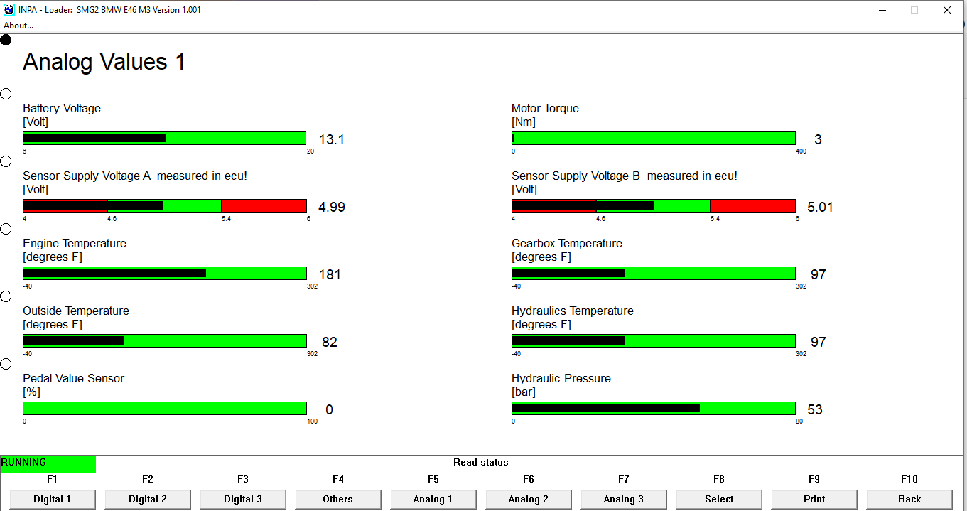

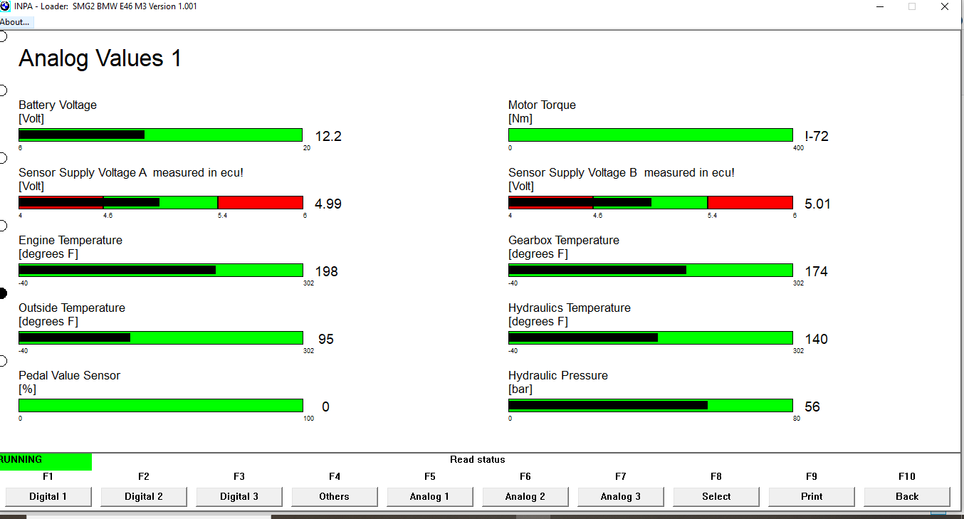

                    Originally posted by beyondm3 View Post
                    Also attached are two photos from the SMG status readouts. One being normal operating (normtemp) temperatures where I can stop and start the car on demand and the second being when the car is hot enough to the point it won't restart (hottemp).
                    When cold, batt=13.1V and when hot, it = 12.2V. something is not right with the reported batt voltage. You should confirm this using a voltmeter to measure at the cigarette lighter. In both scenarios the hydraulic pressure is within the spec: above 45 bar.
                      I should have done a better job explaining the photos, the hot photo is when the car was off as I was trying to pull the "status" whilst the car was in the problematic state. So the car was hot/off and I was attempting to restart. I was hoping the readout would be different enough to point to something obvious.

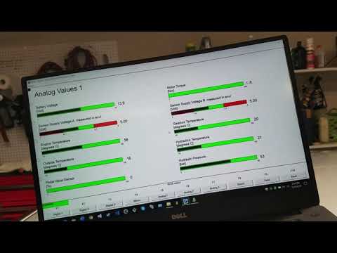

                            Your unit is building pressure a little on the slow side and your pressure decay is really fast. As an example the video below is my SMG unit running for five minutes (four and a half shown in the video) and still not needing to rebuild pressure. My pump's first prime of the day is 8 seconds. Seven to ten seconds is considered normal. Your shift decay is normal. Now the problem is determining whether the true root of your problems are the accumulator, motor, or the internal pump seals.
                            With all the above being said I would still try a clutch and actuator bleed followed by adaptations as robgill suggested. It is possible that air entered the system, but if air entered the system how did it get there? My first bet would be the internal o-rings where the red collet sits on the fluid reservoir that is attached to the pump. After that guesses get more difficult.
                              Amazing good tight system! Is this the result of pump rebuilt with new seals, and new accumulator?
                                Original accumulator but all new seals and o-rings.
