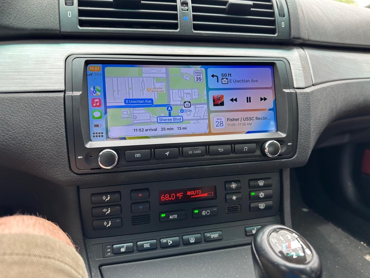

          Yeah, Jeff Bechtel is why I went with them and have been with them this long. One, he's great sales and support. Less well known is how involved he has been in evolving the product. Yes the buttons are a let down but the volume knob, stealth fitment and sound quality mean I rarely use them. Set it and forget it music as far as I'm concerned. My criticism of the N7 Pro and newer is you can no longer turn the screen off like you could on old models by holding the Mute button (which was quietly my favorite feature). People REALLY didn't know it wasn't OE with the screen off.

            I've been 100% pleased with my xtrons, other than it not having a matte screen-- which I'm currently addressing. Would recomend for sure.
            Admittedly I'm in CarPlay 99.9% of the time (basically only leave if I need to use it to pull a code), so can't really comment on the native interface much. Certainly doesn't lag in CarPlay.

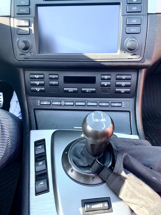

            Looks pretty stock, while having a nicely sized screen. In the 3 years I've been running it, the Xtrons has proven to be bulletproof reliable (unlike the 2 Avins I had before it, despite one of them having an identical front fascia). Install is plug and play. Would recommend.
            Click image for larger version  Name:	image_46528.jpg Views:	0 Size:	204.6 KB ID:	353917
            Click image for larger version  Name:	image_46529.jpg Views:	0 Size:	218.0 KB ID:	353918

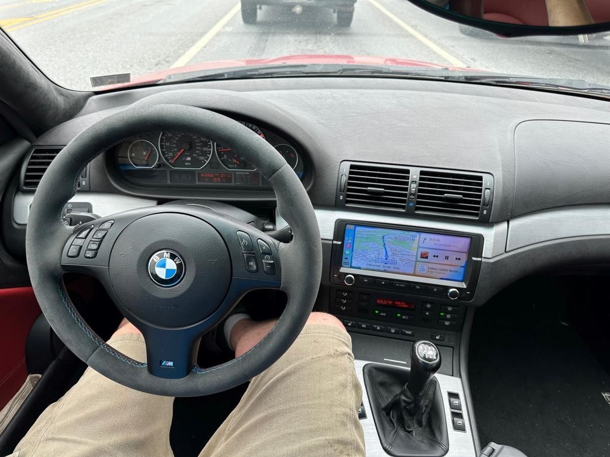

                  I have a vert and curious if anyone has experience with sun/glare with any of the aftermarket units? Any recommendations? Thanks

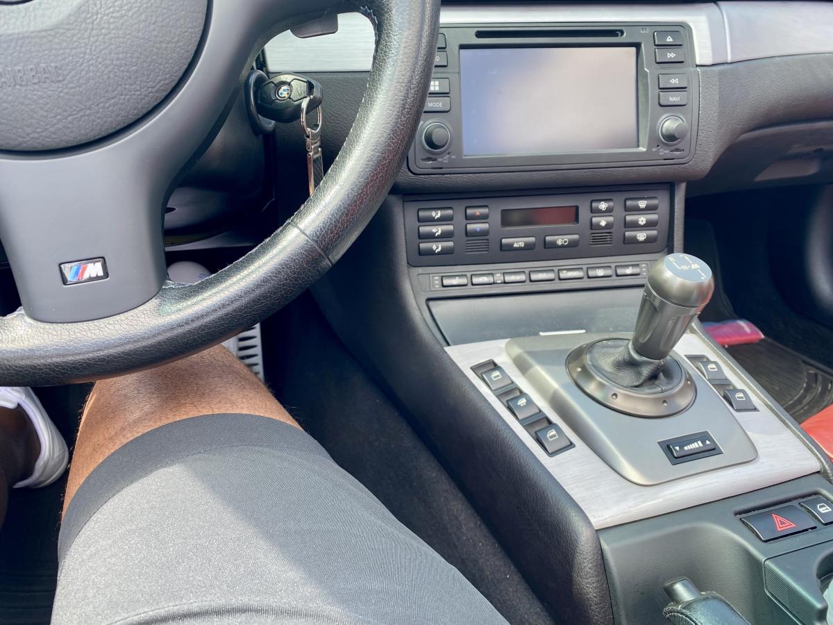

                    Pics below. The screen glare in my convertible in FL is pretty intense. But I'd just as soon have the screen off anyway. I'm only using it for music -- too many screens in life as it is.

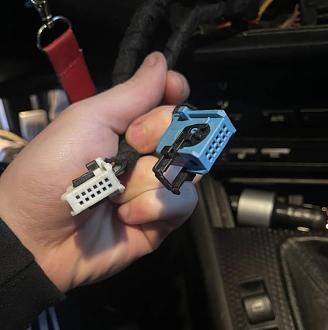

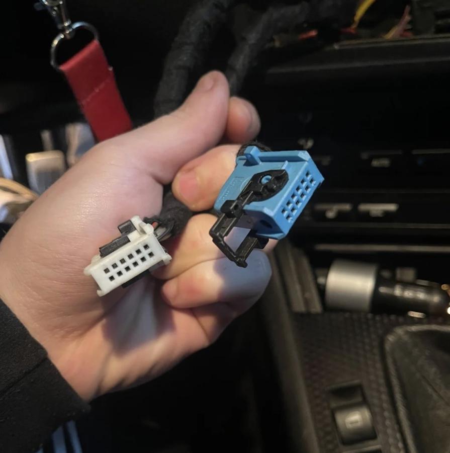

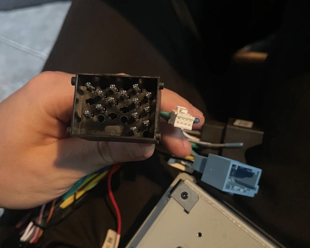

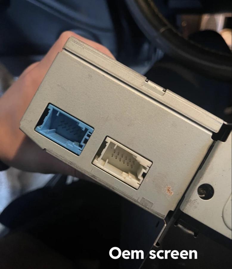

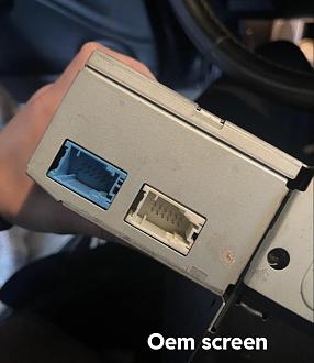

                      Does anyone know what the blue connector for the OE Nav screen is for? There is a blue connector on the Xtrons harness that is keyed for the blue plug and I am wondering if that needs to be connected. The main 6M harness that goes to the trunk does power the unit and it plays audio. Added a few picture of the nav connectors that I found on another post:

                        In theory there is not really a need for the 6m main extension but they just seem to do it that way to cover the lowest spec ie no nav and no HK. You would still need the antenna extension or take over controlling the radio in the BM53/54. There is power, ibus, permanent power, switched power and audio all available on the white connector. After all it can be an audio source via the CD or tape deck.Although there is only two channels the front rear fading is done in the rear BM5x module.
                        The blue connector is just the video signal for the front display. The actual generation is done in the rear in the Nav computer. So for these solutions I don't see any need to connect it as there's no pass through to display the original display on these units.
                        Edit: I might have blue and white wrong way around here in which case blue would have some use but it's overridden by the big extension cable.
                          Doesn’t apply to my car, so I’m very low confidence about this, but don’t only the nav cars need the harness?
                            Doesn't apply to my car, so I'm very low confidence about this, but don't only the nav cars need the harness?
                            That is correct. Only nav cars need the extension as most of the brains are in the back. The non nav cars have the right wiring to front so don't need the extension.
                            My point was there's enough wiring in the blue or white connector to pass audio to the back but they just don't bother using it.

                              whoa. the Xtrons comes with a harness to connect the nav cars to the car without running the extra harness?! Where did you get the converter in the first pic?
                                No, you need to run the 6 meter harness. It is not that bad other than figuring out how to remove the door sill cover. In the video below, ignore where he runs the cable around the fold down rear seats. The better way to route the cable is using the factory foam grommet under the side rear seat cushion that sits under the rear seatbelt. Removing the rear door card also helps.
                                Per Xtrons' instructions, those blue and white connectors for the nav screen are not used.
