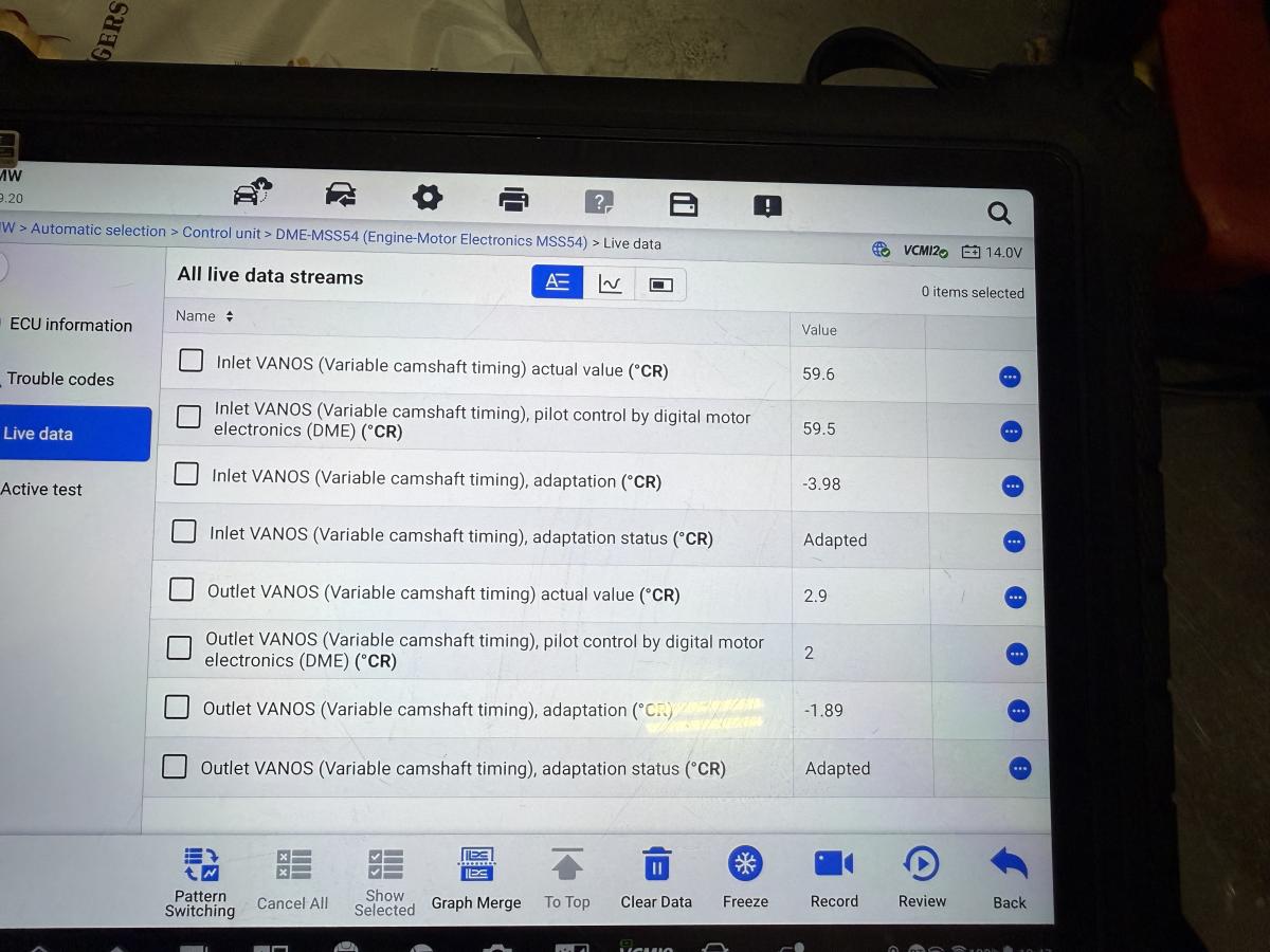

              This is what the scanner came up with after driving for a little!
                Is it worth redoing the timing or should I just leave it as is?
                  I appreciate the detailed reply very much. I’m new to this platform. I haven’t really done much research or know how the system works very well. I just did a head job on the car and I’m going to take it to track next week, but I want to make sure the car is running smoothly before I go and damage something
                    Those values look ok. You can now see it's stored an adaptation value for inlet and exhaust. Exhaust being -3.98 which is approximately the offset from the test failure. Try running the vanos test again now that adaptation values have set.
                      Values are within range. Do you have any trouble codes? These engines are a bit chatty so a tick can be valve adjustment.
