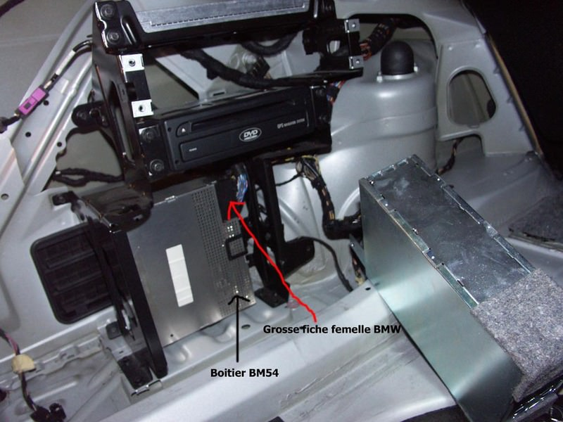

          Are you sure it's not the BM5x radio amp module. It still is used in line before the HK amp.
            Shonky that's a valid point. Thank you. I didn't think about the BM5x radio amp module. Is that the silver thing in front of the amp in the trunk? I wasn't sure if there was anything else inline in the circuit...
            If it's not that it would pretty much have to be the head unit, correct?
              BM53/BM54 hybrid amplifier ICs are notorious for dying.
              Note however at that point there are only four channels - front and rear, left and right. In the HK system it just takes these 4 channels and splits and amplifies them internally so there's 10 separate amplified channels internally. If the noise is only in one driver in the door and not the other speakers created from that channel then it really points more to the HK amp (but you've replaced that), wiring from there or the driver itself (also replaced). It's possible the noise is only lower frequencies so may not really be heard on the other channels.
              Or do you have the old head unit you could try perhaps?
              Random photo I found. On the left of the coupe trunk, below the navigation computer and CD changer if you have them. Behind the TV module and in a HK system I think the HK amp is behind it from memory. If you replaced the amp, I'm pretty sure you would have had it out. It has BM53 or BM54 on the label:
