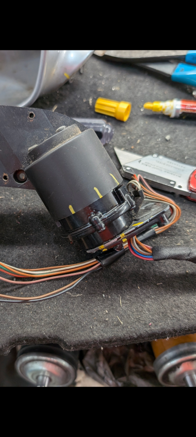

      Imagine they're almost identical
      The manual assembly in the US market manual folding mirrors has a fairly large spring in it.. and when compared to the electric motor assembly, I would imagine it's only a few more ounces heavier. Definitely less than a pound in weight
      That is the only difference between the two mirrors
      That is what the power fold assembly looks like and it's virtually identical in size and weight of the non folding unit.

        Interesting. It makes sense because Real OEM has them both at the same weight. I didn't realize that the spring load mechanism weighted almost the same weight as the electric motor assembly.
