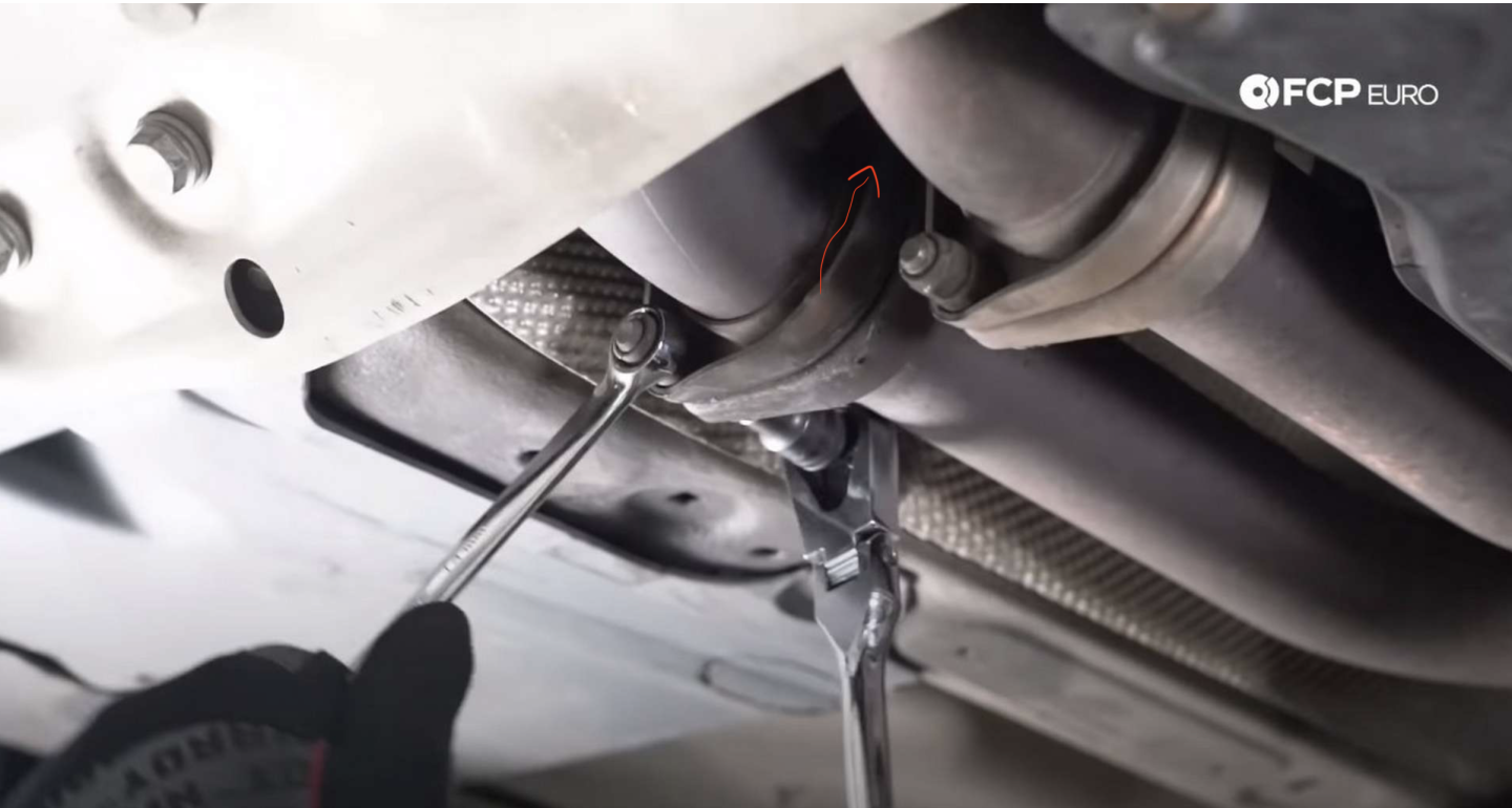

          1. I would replace the missing bolt, I had a rattle with it missing
          2. check if your bolts connecting the mid-pipe to the headers are tight, you know where the two header outputs sit together near the aluminum plate. One of the bolts there is usually difficult to tighten and if not torqued it works itself loose.
            Thank you I am hearing the noise around there, I also bought the gaskets for it! let me make sure they are torque down! I appreciate your time!
