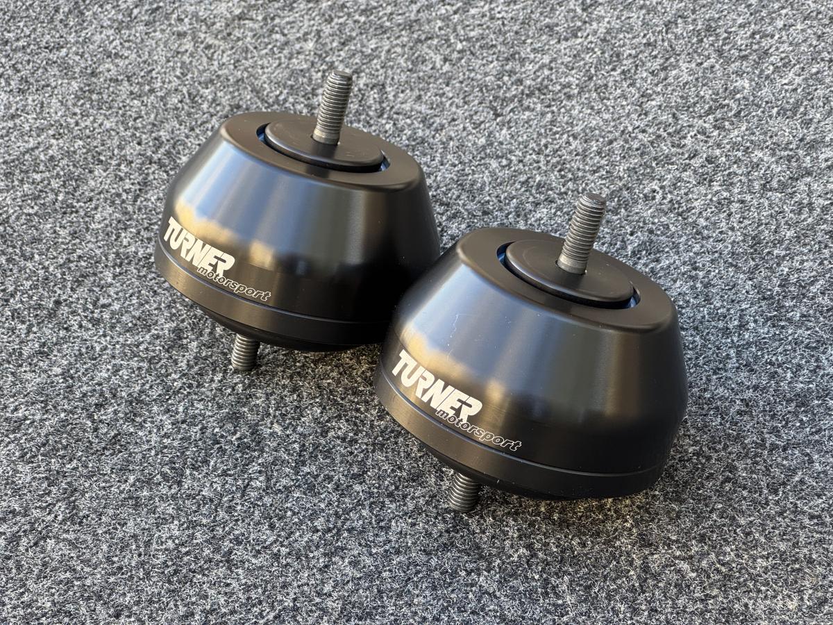

    Note the inversion of the Turner Motorsports Polyurethane 70A motor mounts' relationship between NVH and RPM. They only induce some noticeable vibration at idle. Amazingly, at all other RPM all the way up to redline, they are smooth as butter. No other mount behaves this way. Potentially accomplished by their statically-preloaded poly within the aluminum housing. Every other mount I have tried results in higher NVH with higher RPM, typically peaking at various resonant frequencies throughout the range. Turner has really pulled off a miracle here and somehow made a mount that is smooth throughout the entire range, except at idle, where it is a bit too much vibration for my liking. I really wanted to keep them in due to the buttery smooth operation throughout the RPM range, but the vibration at idle was just a bit too much for me. Admittedly I do like vibration to be nonexistent at idle. If you were to increase idle RPM, it would likely solve this issue. They are a perfect weekend-only / track day car motor mount.

      The captured and preloaded poly design of the Turner Motorsports 70A motor mounts above is noteworthy, however, as they really are smooth as butter above idle all the way to redline, while accomplishing excellent motor control. Pictured below. That is aluminum you see in black, with the preloaded blue poly peaking out from between the outer and inner portions:
