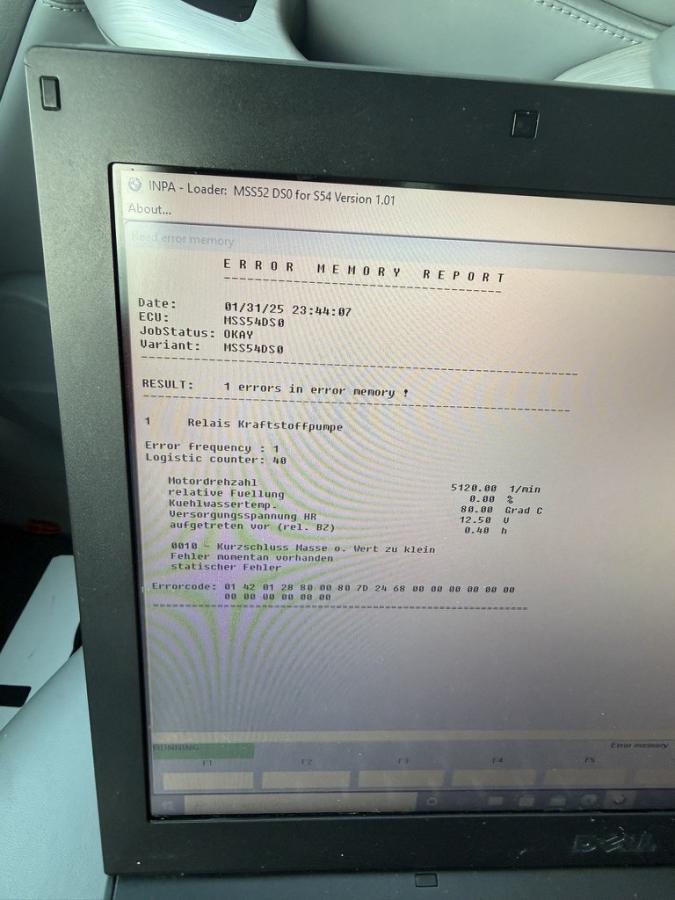

                    Crank is fine. I even get RPM while cranking. Here's the code:
                      Error code = 1.

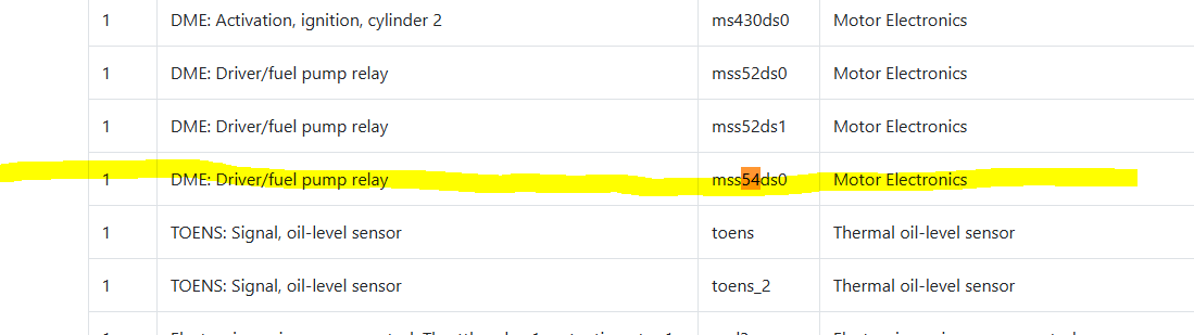

                      The description says nothing about Ground Fault, just fuel pump relay (and I wonder why TIS wiring diagram shows no feedback wires from relay to DME).

                      From this https://bmwfault.codes/Lookup:
