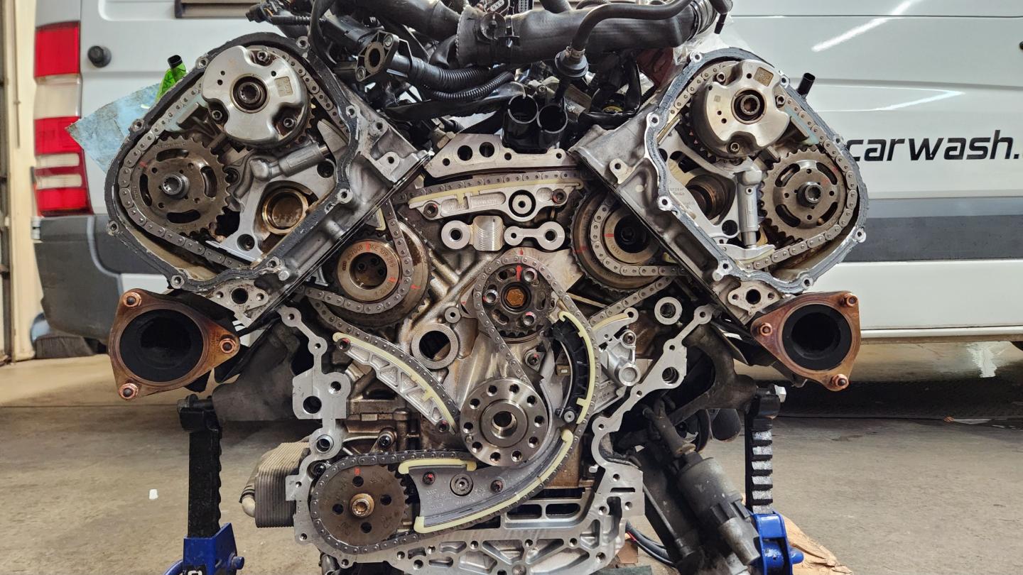

          I'd be really surprised if it was the head head gasket unless the timing cover has been removed. BMW's procedure is to R&R the head when removing the timing cover when there is a timing chain overhang built into the head to prevent the head gasket from leaking.
          But if the timing cover hadn't been removed then I'd be looking elsewhere. Especially the VANOS if is leaking enough to smell it.
            I would get BMW while it's available, if you plan to have the car for a long time. If the surfaces are clean and it isn't a complex sealing surface so VR is probably fine. But that's a big job, wouldn't want to add any doubt if wallet allows.
