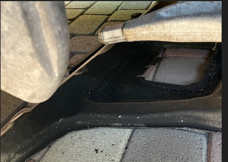

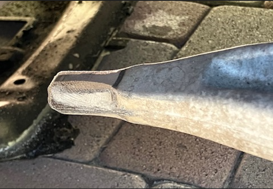

      Today I filed the hex end into a smooth surface for it to rotate inside the bush, lubed the shaft and bushing with grease for low friction. Will see how long it will last. Done on a 325iT car.

      Filed shaft:
      Click image for larger version Name:	image.png Views:	0 Size:	778.4 KB ID:	357683​
                    Filed shaft:

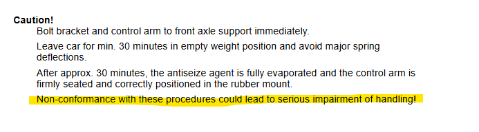

                        To clear up some misinformation, the E36 (and AWD E46) control arms are round, yes, but that is not to allow the arm to rotate in the bushing. In fact BMW specifically states it should NOT rotate in the bushing. When those bushings are installed onto the arms I use turpentine which softens the rubber for install. The car is then set at ride height (quickly) and bounced to settle the suspension. Once the turpentine dries the rubber is "stuck" to the control arm and will not freely rotate.
                        I imagine BMW moved to the hexagon configuration for ease of installation and still prevent the arm from rotating.
                        Also note, the M3 control arm bushing is solid, not oil filled like Non-M. In my experience the M3 bushings last vastly longer than Non-M which have the history of early failures.
                        And from the BMW E46 xi repair instructions

                          "Non-fonformance with these procedures could lead to serious impairment of handling"
                          Appreciate the information.
                          I'm trying to think what serious issue could happen if the shaft end allowed to rotate in the bushing, consider how many times we had driven a car with the bushing completely torn apart. The worst I can remember is the pull to the side during heavy braking, but this happened bc the torn bushing let the wheel be pulled 1" or more rearward. This won't happen if the shaft just rotates in the bushing, wear gratually.
                          The normal wheel going up/down on the road, e.g. speed bumps, road surface, cause the LCA rotating in the bushing with little or no radial force pushing on the rubber, so low wear. This same rotaing arm stresses/twists the bushing in stock setup, leading to fatigued ruptured bushing.
                            It will likely "just" flog out much much quicker and have much less stability as there is progressively less material supporting the load and excess free play meaning deformation under load will be higher which is contra to what the goal with this thread seems to be. A round pin rotating inside the round bush will wear very quick as the pin nor bush is particularly hard wearing material so you need a rod end to do this job which brings the obvious compromises.
                              I installed a new bushing on the rounded shaft end on 6/6/2026 . Will let you know how long it will last.

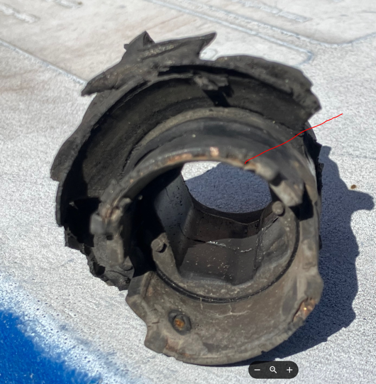

                                This broken bushing inner sleeve shows the metal ring R outer layer after the hex rubber which is about 2mm thick. So if the rounded shaft worn down the hex rubber part, metal ring R will act as a bearing for the shaft to rotate, preventing the rubber bushing B from ruptured as on the stock part.Worst case this will have 2mm plays instead of more than 20mm plays with the completely ruptured donut B.
