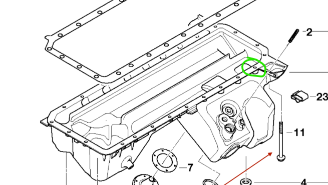

    I managed to strip one of the ~20 M6x1 20mm bolts that go around the oil pan. Unfortunately the location is tight (driver side rear corner, by dipstick), so I think a helicoil would be a challenge. Anyone have any luck going a different route?
    I push it all the way in and it will catch, but won't tighten. Likely will try a 25mm bolt first. It is a through hole, so maybe something creative?
    A nut on top?
      It's the circled one. I'm being told on the E46 M3 Owners group on FB that this is one of the three that is longer (25 mm), which makes sense. There was a 20 mm installed though. PO's shop did the rod bearings so quite possible they put one of the twenty 20mm in there instead of the longer 25mm one. There was one 20 mm missing from the passenger side (I bought a new one and installed), so that would explain where it went. I'm going to try the 25 mm bolt. This all came about because I noticed the missing one on the passenger side, and then checked all the others, since a few around the missing one were quite loose.

              Unless you take the oil pan off and helicoil or timesert it, just leave that bolt off. If that is the only bolt missing, there are plenty of other bolts clamping the oil pan down for the gasket to seal. Plus that is not the lower tilted side of the engine where leaks are more common.
                They put one in that's too short, so I'm going to get the correct length. I'm guessing just the first couple threads are shot, if any. The spot on the passenger side where one was straight up missing wasn't leaking. I can see a couple other spots where I think they put in the longer ones where they shouldn't have (25 mm vs 20 mm), but they're through holes and I'm just going to leave them (no leaks).
