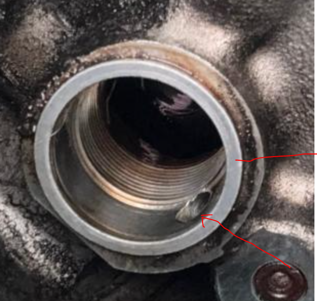

      I don't see the damaged threads in the hole, but there is an object pointed by the red line. Also it seems the AL washer is still hanging at the hole. The threads on the tensioners is a distance from the washer so the hole doesn't have threads until 5mm or deeper into the hole is normal. show us the pic of the damaged threads.

        That "object" is the oil feed hole for the tensioner.
          I know the oil feed hole but the photo seems to show a protruding object haha!
          I can't tell any damaged threads, but it's hard to believe the tensioner can hold the torque at 52 ft-lbs on 2 or 3 bad threads, as all threads deeper than the feed hole seem to be in perfect shape. So there are plenty of good threads in the hole and no need to get the engine or head off the car to repair.
          If it were me, and after verify the couple damaged start threads, I would stuff the hole with paper towel, then use a file or angle pick to clean or delete the bad threads, clean up the debris with cotton swap wet with oil or grease, then try to thread the dumb tensioner (remove the plunger and spring) into the hole for a trail run first.

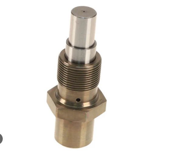

              What is the thread size? McMaster Carr is usually reasonable for that stuff. Might have to go get raped at Fastenal.
                Looks like it is M26 x 1.5 threads and will require a custom made bolt or tap.
