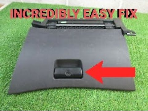

          if it’s stuck locked, is there anyway to make it unlock and disconnect the wires? Once you open up the mechanism?
            This shows how it works:
