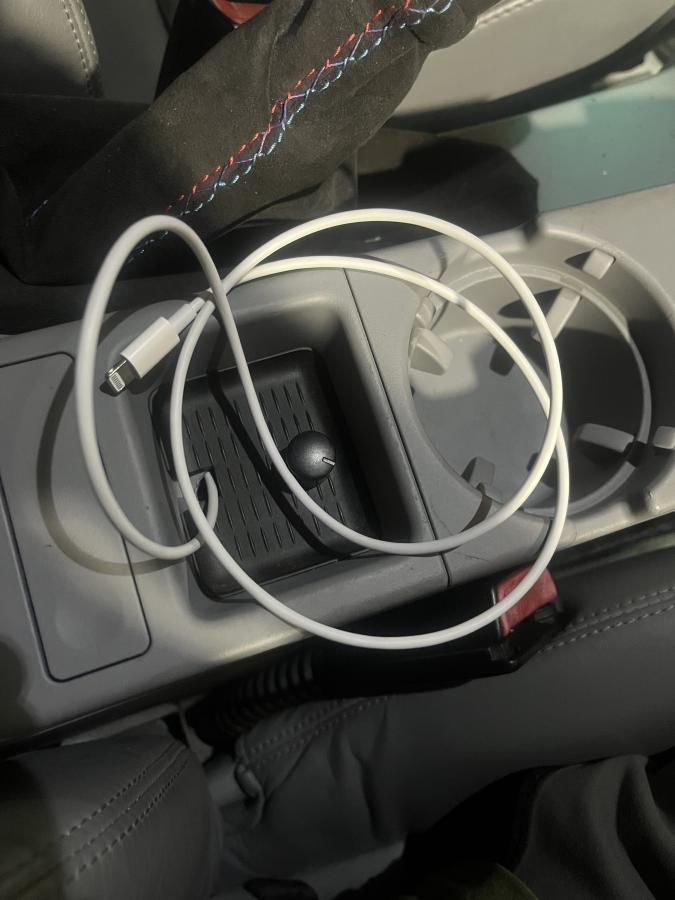

    I wanted a cleaner solution than the cigarette socket for charging my phone. Looking at aftermarket options I saw many reviews of overheating or even fires. This led me to search out an OEM solution that would allow for fast charging (USB-PD) of my phone. It turns out most OEM solutions do not support the USB-PD protocol that allows for higher wattage and if they do they are not self contained in a retrofit friendly package.

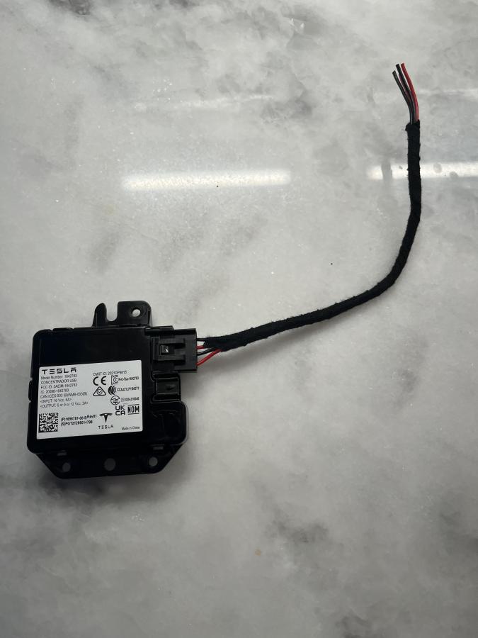

    The Tesla 1656787-00-B module checked all the boxes:
    • Self contained in a small case
    • Only requires a simple power input
    • USB-PD - forum posts of Tesla users upgrading to this module are reporting 20+ watt output
    I purchased it here:
    These genuine used Tesla Model 3/Model Y USB-C charging hubs are perfect for adding fast phone charging to a custom EV build or replacing a failed factory unit. They are especially useful for 2021–2023 HW3 Model 3 and Model Y vehicles, where Tesla removed the data functionality from the front USB

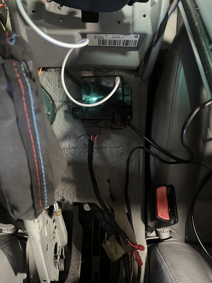

    I used this eBay harness but it looks like you can now get one right from the site above. You will cut one end of the harness off to wire it to the car:
    Click image for larger version  Name:	IMG_1828.jpg Views:	13 Size:	46.7 KB ID:	360053

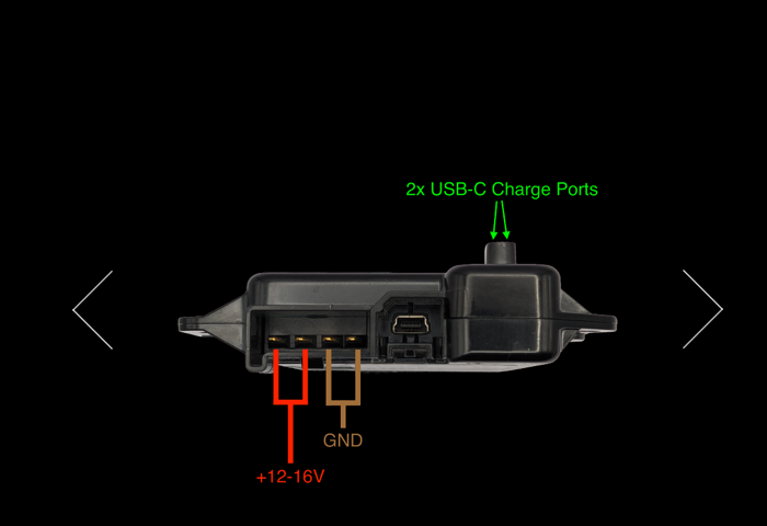

    Here is the pinout - Only 1 set of the power/ground have to be connected. The seller told me they are internally bridged
    Click image for larger version  Name:	Screenshot 2026-06-30 at 10.52.35 PM.png Views:	12 Size:	62.0 KB ID:	360052

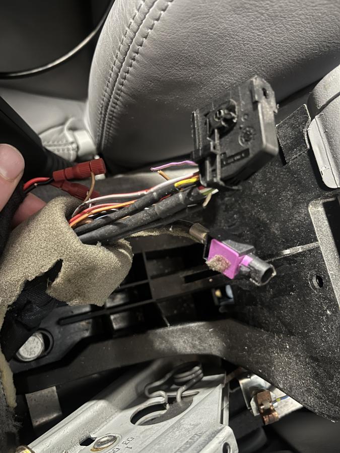

    For the install I used the existing switched power that is part of the car phone harness under the center console. Don't do what the previous owner did and cut the phone harness - use a tap instead. Too late for my car.
    • Purple/White = 12v
    • Brown = Ground
    Click image for larger version  Name:	IMG_1829.jpg Views:	12 Size:	108.2 KB ID:	360054

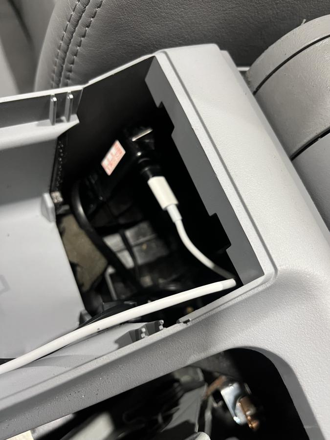

    Testing - it was able to charge my iPhone from 2% to 80% in 30min. No heat from the module or wiring. It should be noted this module is rated to 6amp, the phone circuit is rated to 5amp. The module would only ever consume that if it were charging two devices at max output. I feel comfortable only using this for a single phone.
    Click image for larger version  Name:	IMG_1830.jpg Views:	12 Size:	76.9 KB ID:	360055
    It tucks in nicely behind the coin tray. If you ever have to change the charging cable that is all you have to remove.

        You buy either the pin kit from the module seller or the eBay harness. Something to note on the eBay harness - the red/black wires do not correctly match power and ground pins - you will need a volt meter to identify the right wires to connect to the car.

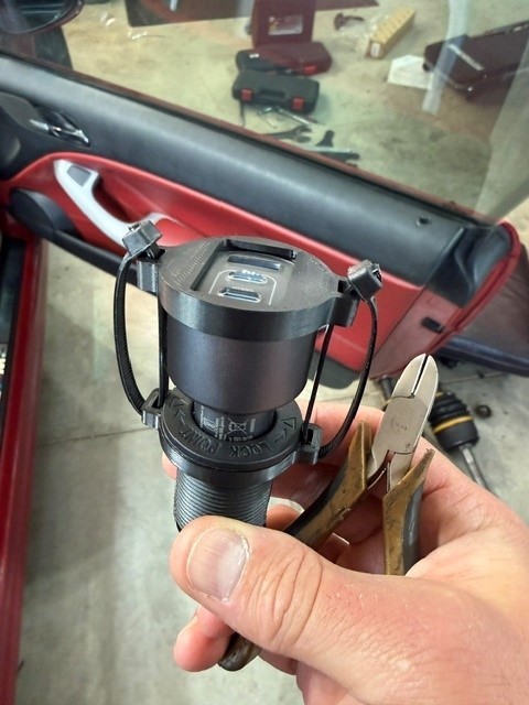

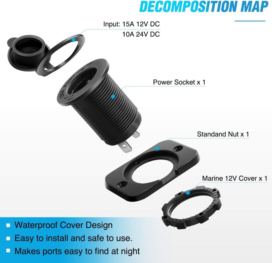

              I have something like the "power socket" below behind the dash:
              Click image for larger version  Name:	71YCRBd72mL._AC_SL1500_.jpg Views:	0 Size:	67.7 KB ID:	360091
              I snipped down the prongs to match the factory size, and just moved the connectors from the factory cigarette lighter to this, thus not modifying any stock wiring :P
              ... and then 3d printed this contraption to zip tie hole it from being able to vibrate apart.
              Snipping and soldering would be much cleaner/easier, if I didn't want to avoid permanently altering factory wiring.

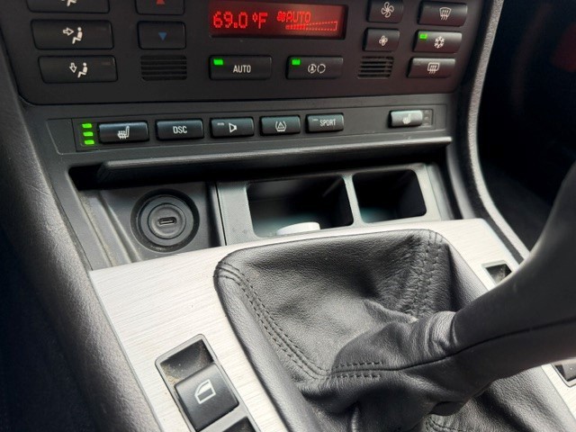

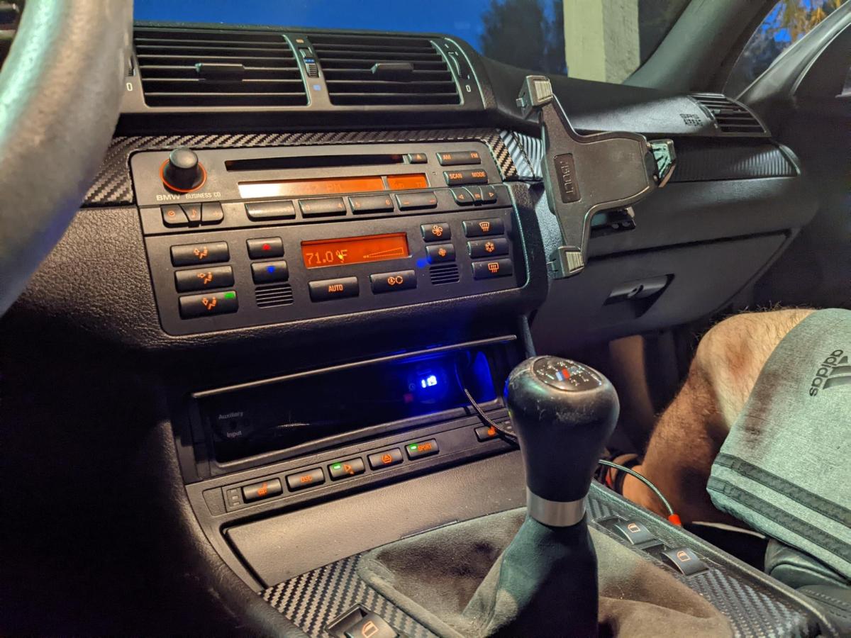

                    I'm not sure what you're asking, but this is what I replaced my cig lighter with (and it is an exact fit replacement for the cig lighter housing):
