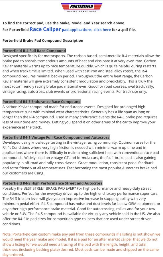

                    I’m a real fan of Porterfield pads. In fact, they’re a short drive from you; they’re located in Costa Mesa. The R4S pad works very well for street. They work in autoX, but don’t expect real stopping like the R4E compound, which will test the seat belt tensioner in your sled.
