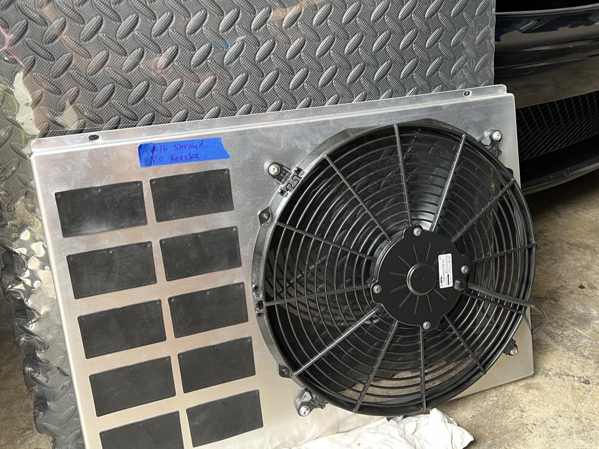

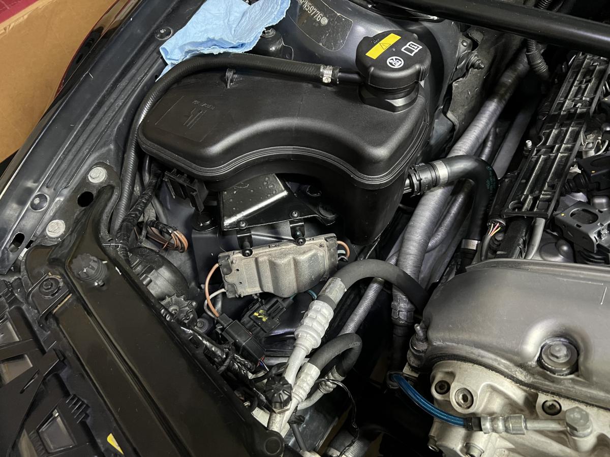

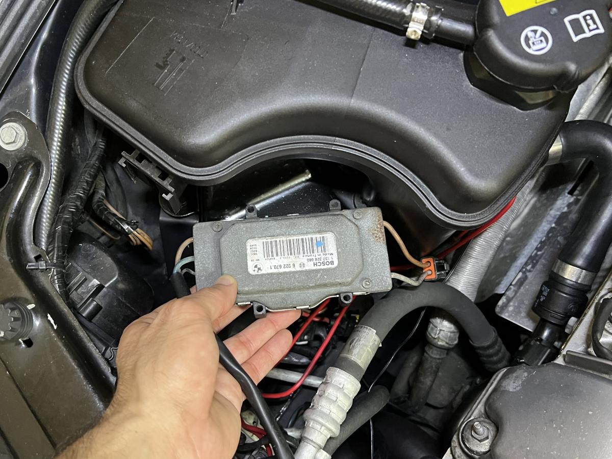

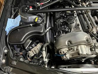

    Hey all, wow it’s been awhile since I’ve posted! I’m converting my cooling setup to having the factory Aux Fan controller running my main puller cooling fan (14” SPAL mounted in Zionsville shroud, not yet installed, front aux fan shroud already been removed for track cooling improvement), and stumped how to properly mount the controller box in the engine bay. Looking how to safely and securely mount it and I’m also under the assumption it needs some cooling airflow, like how in its factory mounting location it’s in airflow in the front aux fan shroud?
    Even considered maybe drilling holes into the side edge of the Zionsville shroud and bolting it there but dont want to go down that route yet. I dont have a 3D printer of my own either.
    How did those of you who are running the aux fan controller + main cooling fan setup end up mounting it? Thanks!​

          Hey George! Yeah no room on this one for mounting like that, since the space where the fan isnt mounted has relief flaps, unless i want to mount it over one of them and cover it. Which may be actually beneficial for the controller’s cooling requirements hmm

              Why does the controller need to be cooled?
                I wouldn't sweat the "cooling" aspect of the fan controller. The one I posted is a daily driven S/C E39 540 (320k miles) and we've had no issues with the fan (it doesn't have an aux fan either).
                Are you still running the stock oil cooler shroud? If not you could probably hang it off the fan shroud in the bottom RH corner.

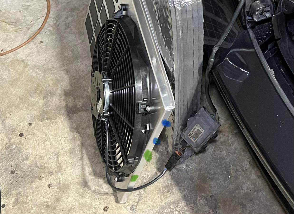

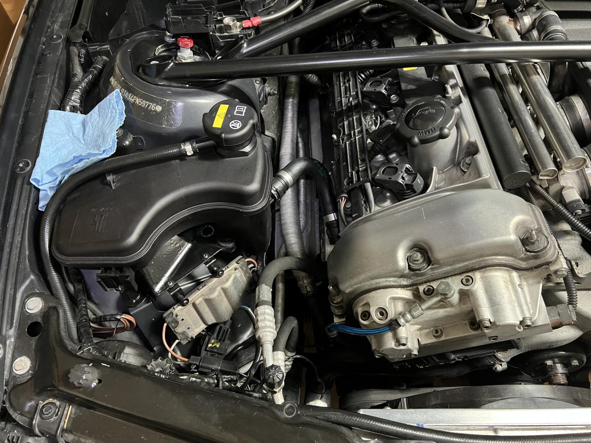

                  Quick follow-up in case anyone was curious or finds this thread in the future; I completed the zionsville fan shroud install and aux controller mounting job this past wknd. I ended up just using a couple furniture L brackets from Amazon and M4 hardware to mount the controller to the SAP bracket, which i had already cut down when I installed a new coolant expansion tank a few months ago, tucked some of the excess harness behind it. Happy with it and was simple enough, not the prettiest but seems solid so far during street driving, and still much cleaner than the Mishimoto e-fan kit it replaced which had a bunch of unsightly wiring running to the fan from the positive terminal and its fan controller that was mounted in the drug bin.
