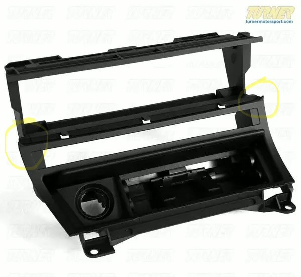

          Thanks! This is useful, I still dont get what the thing without rounded corners is for 51168268891
            Click image for larger version  Name:	IMG_9305.jpg Views:	0 Size:	50.5 KB ID:	363222 The cars that are equipped with factory nav have the hvac positioned in the lower section of the center console. The frame for those cars have little curved wings that stick up, mirroring the corners of the hvac control panel.
            What causes issues is when people move the hvac controls panels upwards then try to put something else in its place. Because the little curved wings stick up, panels such as sunglasses trays (or anything fully rectangular) won’t fit in that opening. The “correct” way to do it is to replace the panel with the genuine version that has fully flat edges.
            For your exact situation with your car being a track car, I’d remove the panel, then use a dremel or file to grind down the wings. This way you’ll be able to install your gauge panel in the standard frame with some basic mods.

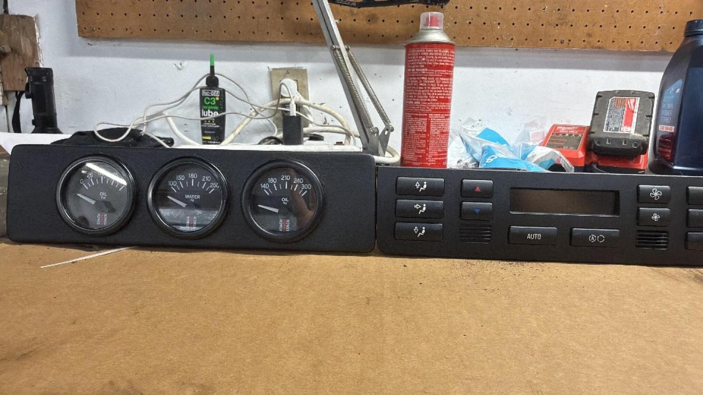

              Click image for larger version  Name:	518e8fdf4880737d7938c31ab22d8d7d.jpg Views:	0 Size:	172.2 KB ID:	363229 hmm that makes sense. Now I think removing the rounded corners might not suffice, since the gauge panel height is taller than the hvac module, so there must be another difference in dimensions of the lower bracket
              I bought this on marketplace so at first I was suspicious that the gauge panel might have been something else than what I was told, but I trust the seller and he sent me a photo of it installed in his car in that same position so it must be that lower bracket

                  If you look at the top of the panel the upper portion actually makes the opening shorter as the sunglasses tray/storage box is actually taller than the HVAC display.
