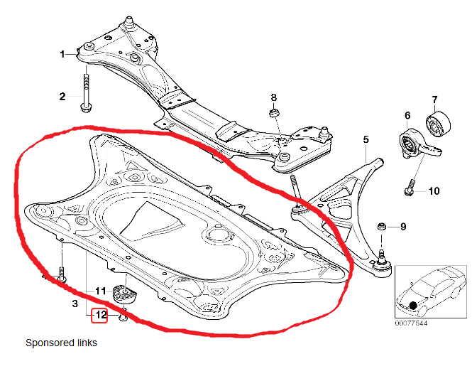

Were you able to retain the under body panel (photo attached with pane circled in red)? On the AKG Motorsports DTM style control arms ( https://www.akgmotorsport.com/produc...-and-z4-not-m/), you can't retain this plate.

You can keep the plate with dtm control arms, it will mount just fine but it will not connect with the control arm mount points.Originally posted by Feffman View PostWere you able to retain the under body panel (photo attached with pane circled in red)? On the AKG Motorsports DTM style control arms ( https://www.akgmotorsport.com/produc...-and-z4-not-m/), you can't retain this plate.
Feff
I am going to have an extention welded to my plate in the future and source a longer bolt to reconnect on it to the control arm on the subframe mounting point.
The rear mounting point (fcab) is not possible to connect unless you have a custom mount made.

Altaran:Originally posted by Altaran View PostYou can keep the plate with dtm control arms, it will mount just fine but it will not connect with the control arm mount points.
Which of the DTM control arms are you currently using? Any photos of the control arms with the plate in place? 🙏
